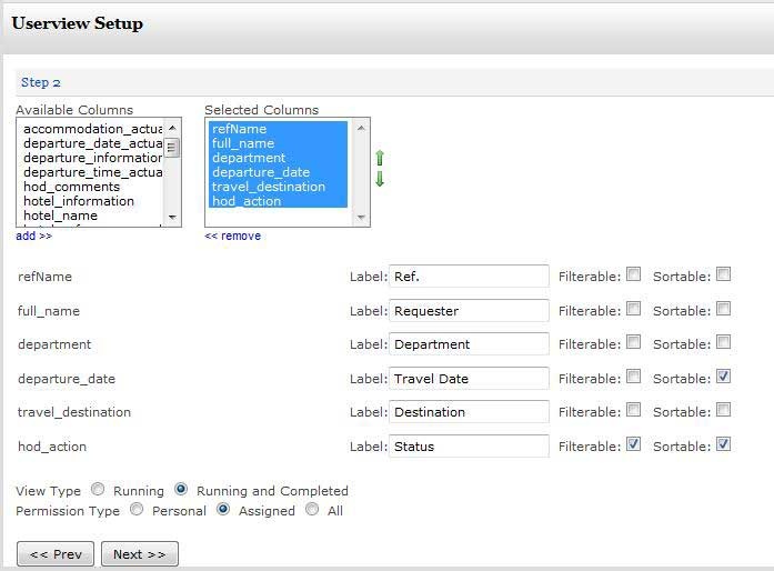

In Joget v2 when creating a Userview you can customize the columns to be shown, thatfrom all the columns available in the process as shown in the image:
However, in the v3 is only possible to display data from DataList and this in turn can only display data from a form or process input tray, so you can not display personalized information as in the previous version.
Am I right?
Is there a way to build a DataList from all available variables in the process?

Hi Andres, the feature you mentioned, is not available in v3 Beta. However, the development team is working on enhancements for the final release of v3, to support for assignment summary, similar to the one we are currently having in v2.
