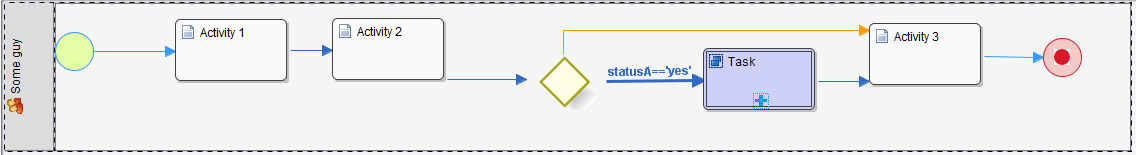

- Start process A

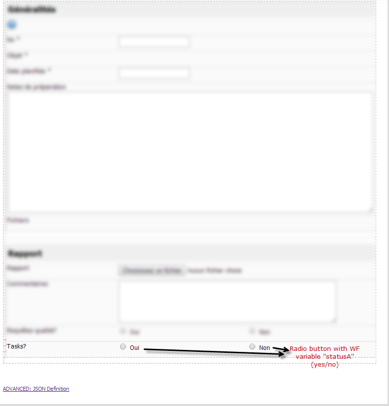

- Activity 1 (Complete ‘’Creation’’ form)
- Activity 2 (Complete ‘’Planning’’ form)

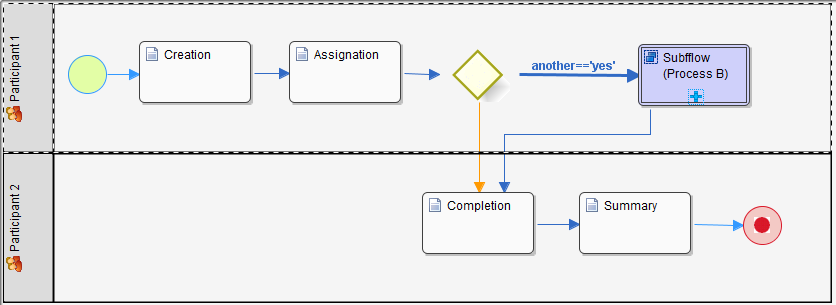

- Start subflow/subprocess (Process B) with actual parameter/WF variable (statusA)
and subflow parameter/WF variable (statusB)- Activity 1 (Complete ‘’Creation’’ form)
- Activity 2 (Complete ‘’Task assignation ’’ form

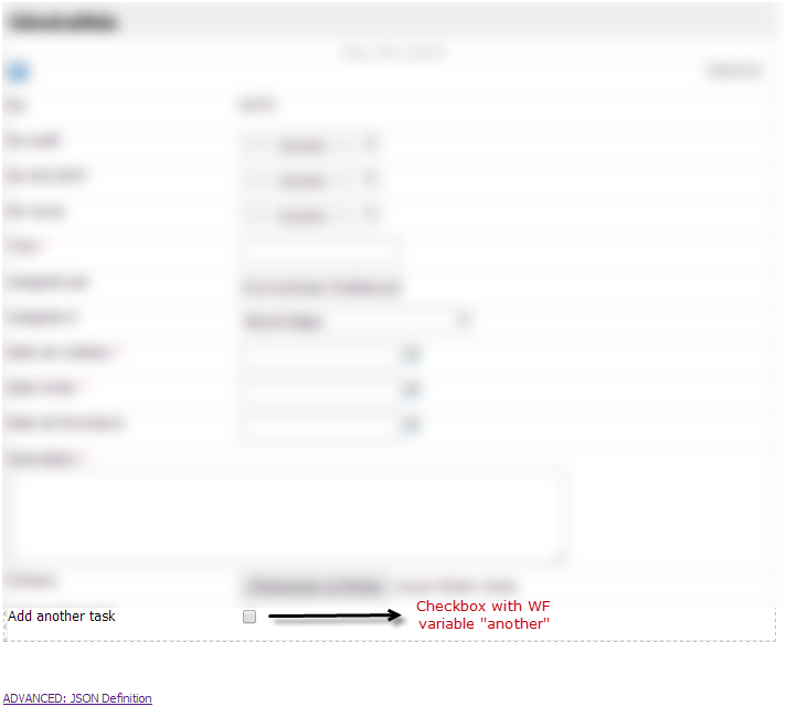

// I would like to loop these activities (1-2) with a checkbox or any other form field linked to a wf variable (‘’another’’)
to create as much (task for example) as I need to (Each task having its own ID and following to the next activities
(2-3-4-5 below) in the workflow) until I uncheck the box// for now I've tried to make the subflow start itself as a subflow - Activity 3 (Complete ‘’Task completion’’ form)
- Activity 4 (Complete ‘’Task summary’’ report)
- End subflow (Task)
- Activity 4 (Acknowledge)
- End of Process A

Hi March,
Nice design there. I didn't quite get your question since you have all your process designed out already. What is your current challenges?
You may want to consider this design as well in your development - Multiple Approval
Cheers
Riocold
I'm doing something similar but I haven't been able to create multiple children subprocess. How can I achieve that? Is it possible?
