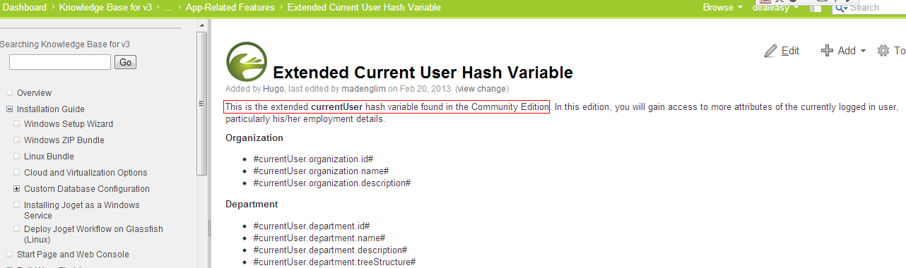

I found that the knowledge base in v3 community edition, it support Extended Current User Hash Variable. please see the pic.
Hi dealeasy,
Extended Current User Hash Variable is a feature only available in the Enterprise Edition. Current User Hash Variable on the other hand is available in the Community Edition.
The reason why it is called as "Extended" because it uses the same hash variable prefix,currentUser as the one found in the community edition.
Hope this clarifies things.
