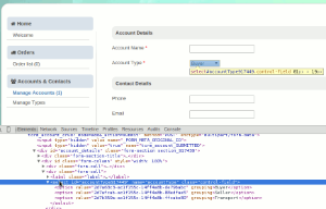

EDIT: I see that the only difference is the fact the you used Category as a separate form and in my case it's hardcoded dropdown select box in Account form. I'll try your way to see how it works. Thanx again.
EDIT2: Now filtering is OK but I cannot get Sections in my main form to show/hide. They are not responding now to "Field ID to control this Section" and "Field value to display this Section". Your method seems to uses "Grouping" in final HTML instead of "Value" so I don't know how to show/hide sections in my form using this FieldID and it's value.

Thank you Owen but you misunderstood my problem. The link you gave me has Select box with hardcoded options and that is the case where Section hide/show works perfectly. Unfortunately I'm not able to filter my list this way.
Then Hugo gave me a solution for filtering that worked but then I cannot manage to get my Section hide/show working. In Hugo's app the Select box does not have hardcoded options (like in the link you gave me) but Form binding options instead.
