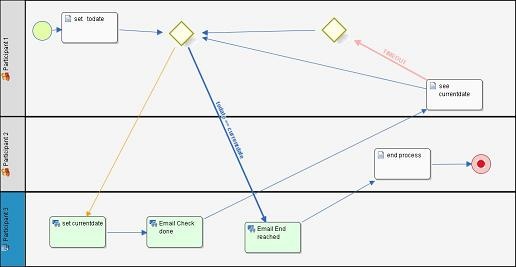

I have tried to use the deadline plugin which has an issue when I try to send email using email plugin or update workflow variable using beanshell plugin after deadline timeout occur. The process is as shown below:
If the process was run without waiting for the deadline time out it works properly, and if we waited for the time out to occur, it reaches the final activity however it fails to send emails, Please advice.

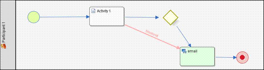

Ti investigate I made the following process:
When the process is run it sends an email, however if actitiy1 did not complete and is allowed to timeout, the email is not sent. When looking at the Audit trail windows I found the following:

Clearly the tool was executed by roleAnonymous (lost the admin role after timeout) which did not have permission to send email. Please advice since this is a show stopper for me.,

Can you please validate this. It only takes few minutes with one activity and one tool as displayed in the second picture I attached. I have compiled the sources after many hours of trial and failure due to the lack of information provided, but at the end I got a sucessful compilation and the issue is still present. Thanks.
