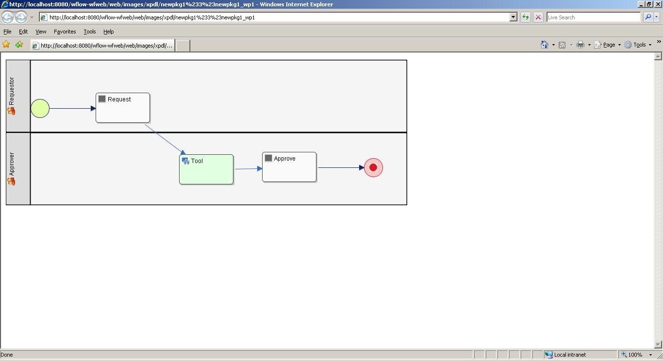

I just wrote a custom participant beanshell plugin (DynamicUserMapping.java) which will simply fetches all the users available in the directory manager and added that to a collection and then returned it from the plugin.
I have designed my workflow (dynamicUserWF.JPG) in such a way it will have 2 participants with a requestor and approver, for the requestor I just mapped it to one of the user as participant and for the approver I have added a tool which is mapped to the above mentioned plugin to fetch the users and return the array of users and another activity in the same which will approve the request (assignee for this activity should be the users returned by the plugin).
But when i ran the process, the user is not getting assigned dynamically (but it is able to fetch the User details), instead the activity is going to the inbox of the Requestor itself (in my case it should be assigned to all the users).
Kindly let me know whether Im missing something here or your comments if any.
Thanks,
Vignesh
You should put our coding at Participant Mapping -> Map to Plugin -> Beanshell Plugin instead and not as a tool's plugin.
Hope it helps!
Vignesh Balasubramanian
Thanks a lot Hugo, it worked!!! :)
