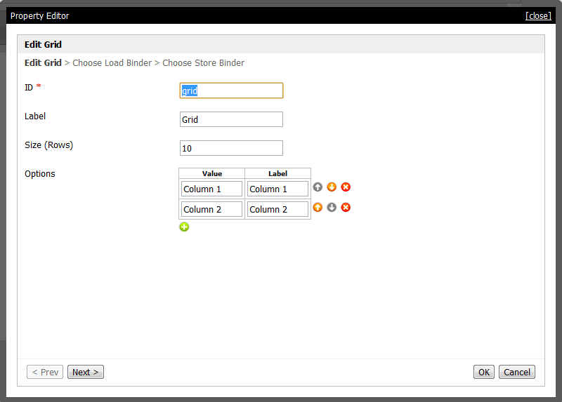

Doesn't the Grid element in Form Builder serve your needs?
Using the Grid element, you can specify the 4 columns, in the "Options" of the Property Editor.

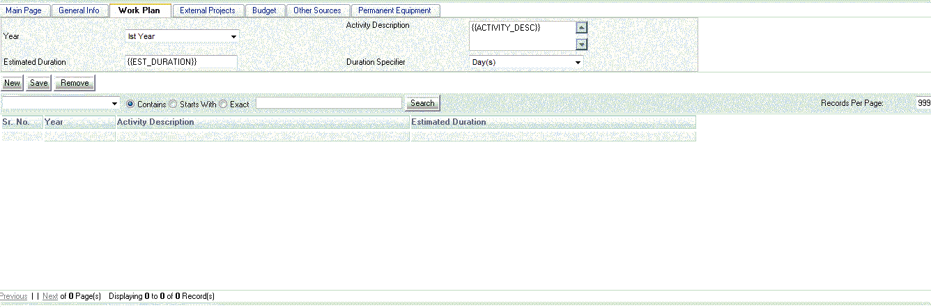

Question 1: - Here user wants to add more then one record recursively by pressing new button again and again can edit old one also. How we can map this type of form for an activity. I mean user wants to add more and more records staying on same activity. In v2.0 there was an editable datagrid where we can insert html input control in cell. Please suggest the solution as we are in trouble and your early response will be highly appreciated. (see screenshot at message end)

Add/remove rows
The screenshot you have attached doesn't look like one that is built using the earlier version of Joget. By default, in grid element, one can already add/remove rows in both version 2 and the new version 3.
