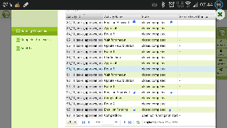

Francisco Muro
I think those activities are triggered, see attached file. What else coud be wrong and what to see (maybe other log in the cloud service idk).
