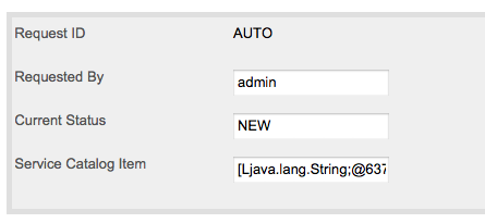

I want to add a URL link to my menu to start a process, however I want to pass the process some default values for some of the workflow variables. I understand that the way to do this is to append 'var_<variable_name>=<variable_value>' to the end of my URL. However when I do this and try to load the variable in a form using the hash variable #variable.<variable_name># instead of seeing the value I passed in my URL I see this (the field Service Catalog Item is what I tried to pass using a URL parameter):
Any idea why this is happening, and why passing data to the workflow variables via URL parameters is not working?

Hi Hugo,
I have checked the variable in the running processes and it shows me exactly the same value 'java.lang.String...'. My form is already loading this workflow variable via a hash variable.
The only extra problem I can think of is that this field is in a sub-form, and these aren't working for me at this time. Perhaps this is related?

Hi Hugo,
I've started the process and entered the value in the form manually. However when I save the form the value is not passed correctly to the workflow. When I inspect the value in the process monitor it is empty, even though I have configured the form to update the workflow variable.
I'm starting to suspect that this has something to do with the problems I have having with sub-forms.
