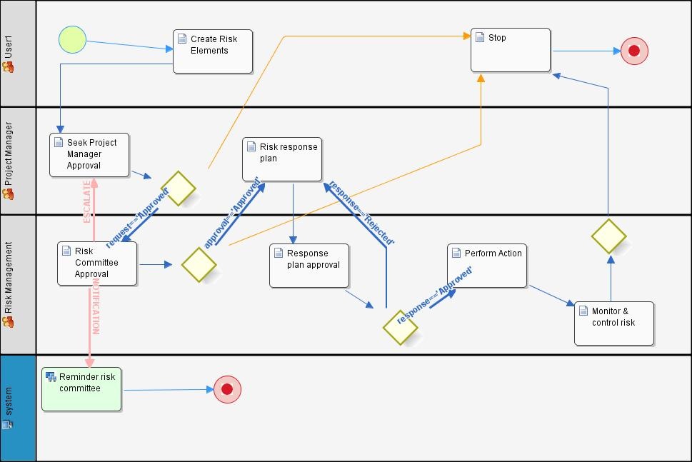

I am a newbie in Joget Workflow. So far I have managed to design a workflow and created form according to the design and even managed to create datalist and userview. But I am all stuck in a position that is Reminder and Escalation. I have gone through the videos and tutorial of this reminder and escalation and managed to design the reminder and escalation at the design workflow section. But I have know Idea how to show them to the Userview section of my app.
So please help me on this. I am attaching the jpeg image where you can find the Reminder and Escalation at the bottom left of the image. So please suggest anything which can help.

What are you trying to trigger?
There's no attachment from your posting by the way.

I am extremely sorry that I have forgotten to attach the image there. I want to know suppose I have designed a workflow at the workflow designer. There I put a Reminder section and a Escalate section. But you know its easy to design there but I could not implement the very same thing at the process where a user can get Reminder mail and escalation mail in the Proper time. People will see the application in web browser. So how can I show the incoming mail at the user end.
I am attaching the same image here.

Have you enabled the Deadline Checker Interval? See "Setting Deadlines - A Step-by-Step Guideline" under Deadlines and Escalations. If you have already done so, then you can monitor if the target activity has been created or not under Monitor Apps.
Hope this helps.
