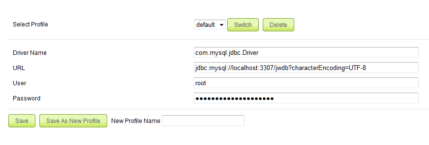

Here's the datasource config of my local server:
Also, there is no password for the root account. The page automatically inserts those input mask "dots" in the Password field whenever I save it blank.

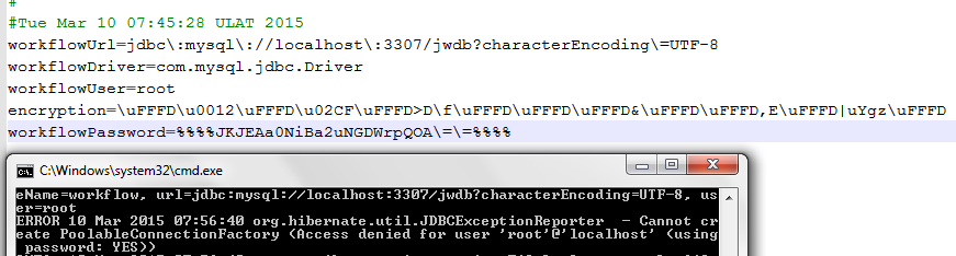

D:\SVEN\joget\wflow\app_datasource-default.properties
# #Thu Mar 05 16:51:44 ULAT 2015 workflowDriver=com.mysql.jdbc.Driver workflowUrl=jdbc\:mysql\://localhost\:3307/jwdb?characterEncoding\=UTF-8 workflowUser=root encryption=\u0019\uFFFD\uFFFD\r'4Q\uFFFD9\uFFFDYf\u0004ce\uFFFD\u0015\uFFFDsz\uFFFD_jg profileName= workflowPassword=%%%%QJvMiQJCBHj1PBOFeSMEPA\=\=%%%%

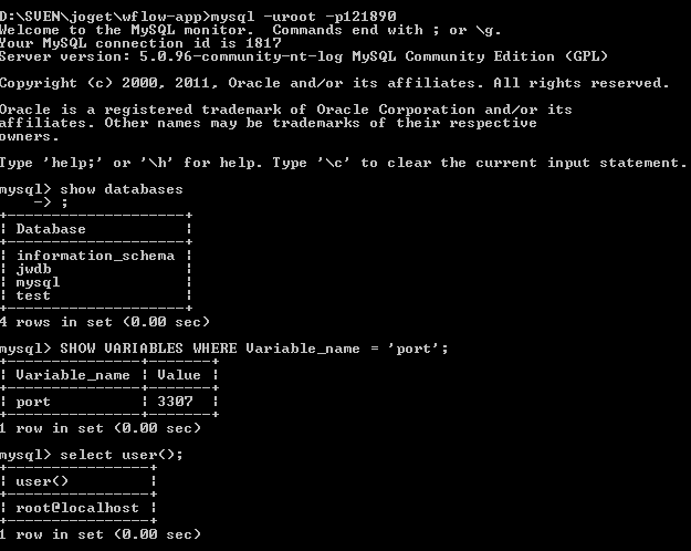

*root does not have a password

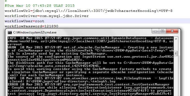

According to the instructions and other forum posts, I should also modify:
C:\Users\SVEN\wflow\app_datasource-default.properties
so here it is:

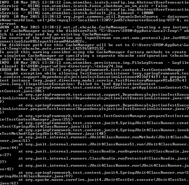

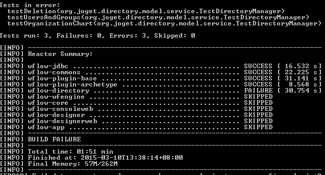

But I still get the error:
SUREFIRE FILES:
org.joget.directory.model.service.TestDirectoryManager.txt
org.joget.directory.model.service.TestDirectoryManager.xml
T E S T S
Running org.joget.directory.model.service.TestDirectoryManager
INFO 05 Mar 2015 16:47:45 org.joget.commons.util.SetupManager - Using base directory: C:\Users\SVEN\wflow\

INFO 05 Mar 2015 16:47:51 org.joget.commons.util.DynamicDataSource - datasourceName=workflow, url=jdbc:mysql://localhost:3307/jwdb?characterEncoding=UTF-8, user=root
ERROR 05 Mar 2015 16:47:52 org.hibernate.util.JDBCExceptionReporter - Cannot create PoolableConnectionFactory (Access denied for user 'root'@'localhost' (using password: YES))
INFO 05 Mar 2015 16:47:52 com.atomikos.persistence.imp.FileLogStream - Logfile closed: D:\SVEN\joget\wflow-directory\.\tmlog9.log
INFO 05 Mar 2015 16:47:52 com.atomikos.icatch.imp.thread.TaskManager - THREADS: using JDK thread pooling...
ERROR 05 Mar 2015 16:47:52 org.springframework.test.context.TestContextManager - Caught exception while allowing TestExecutionListener [org.springframework.test.context.support.DependencyInjectionTestExecutionListener@5505ae1a] to prepare test instance [org.joget.directory.model.service.TestDirectoryManager@73cd37c0]
java.lang.IllegalStateException: Failed to load ApplicationContext

Caused by: org.hibernate.HibernateException: Hibernate Dialect must be explicitly set
at org.hibernate.dialect.DialectFactory.determineDialect(DialectFactory.java:57)
at org.hibernate.dialect.DialectFactory.buildDialect(DialectFactory.java:39)
at org.hibernate.cfg.SettingsFactory.determineDialect(SettingsFactory.java:426)
at org.hibernate.cfg.SettingsFactory.buildSettings(SettingsFactory.java:128)
at org.hibernate.cfg.Configuration.buildSettingsInternal(Configuration.java:2090)
at org.hibernate.cfg.Configuration.buildSettings(Configuration.java:2086)
at org.hibernate.cfg.Configuration.buildSessionFactory(Configuration.java:1311)
at org.springframework.orm.hibernate3.LocalSessionFactoryBean.newSessionFactory(LocalSessionFactoryBean.java:814)
at org.springframework.orm.hibernate3.LocalSessionFactoryBean.buildSessionFactory(LocalSessionFactoryBean.java:732)
at org.springframework.orm.hibernate3.AbstractSessionFactoryBean.afterPropertiesSet(AbstractSessionFactoryBean.java:211)
at org.springframework.beans.factory.support.AbstractAutowireCapableBeanFactory.invokeInitMethods(AbstractAutowireCapableBeanFactory.java:1369)
at org.springframework.beans.factory.support.AbstractAutowireCapableBeanFactory.initializeBean(AbstractAutowireCapableBeanFactory.java:1335)
... 37 more

INFO 05 Mar 2015 16:47:52 com.atomikos.icatch.config.imp.AbstractUserTransactionService - USING com.atomikos.icatch.log_base_name = tmlog
INFO 05 Mar 2015 16:47:52 com.atomikos.icatch.config.imp.AbstractUserTransactionService - USING com.atomikos.icatch.console_file_limit = -1
INFO 05 Mar 2015 16:47:52 com.atomikos.icatch.config.imp.AbstractUserTransactionService - USING com.atomikos.icatch.max_timeout = 300000
INFO 05 Mar 2015 16:47:52 com.atomikos.icatch.config.imp.AbstractUserTransactionService - USING com.atomikos.icatch.tm_unique_name = 192.168.56.1.tm
INFO 05 Mar 2015 16:47:52 com.atomikos.icatch.config.imp.AbstractUserTransactionService - USING java.naming.factory.initial = com.sun.jndi.rmi.registry.RegistryContextFactory
INFO 05 Mar 2015 16:47:52 com.atomikos.icatch.config.imp.AbstractUserTransactionService - USING java.naming.provider.url = rmi://localhost:1099
INFO 05 Mar 2015 16:47:52 com.atomikos.icatch.config.imp.AbstractUserTransactionService - USING com.atomikos.icatch.service = com.atomikos.icatch.standalone.UserTransactionServiceFactory
INFO 05 Mar 2015 16:47:52 com.atomikos.icatch.config.imp.AbstractUserTransactionService - USING com.atomikos.icatch.force_shutdown_on_vm_exit = false
INFO 05 Mar 2015 16:47:52 com.atomikos.icatch.config.imp.AbstractUserTransactionService - USING com.atomikos.icatch.default_jta_timeout = 10000
INFO 05 Mar 2015 16:47:53 org.joget.commons.util.DynamicDataSource - datasourceName=workflow, url=jdbc:mysql://localhost:3307/jwdb?characterEncoding=UTF-8, user=root
ERROR 05 Mar 2015 16:47:53 org.hibernate.util.JDBCExceptionReporter - Cannot create PoolableConnectionFactory (Access denied for user 'root'@'localhost' (using password: YES))
INFO 05 Mar 2015 16:47:53 com.atomikos.persistence.imp.FileLogStream - Logfile closed: D:\SVEN\joget\wflow-directory\.\tmlog10.log
ERROR 05 Mar 2015 16:47:53 org.springframework.test.context.TestContextManager - Caught exception while allowing TestExecutionListener [org.springframework.test.context.support.DependencyInjectionTestExecutionListener@5505ae1a] to prepare test instance [org.joget.directory.model.service.TestDirectoryManager@4331d187]
at org.springframework.test.context.TestContext.getApplicationContext(TestContext.java:201)
at org.springframework.test.context.support.DependencyInjectionTestExecutionListener.injectDependencies(DependencyInjectionTestExecutionListener.java:109)
at org.springframework.test.context.support.DependencyInjectionTestExecutionListener.prepareTestInstance(DependencyInjectionTestExecutionListener.java:75)
at org.springframework.test.context.TestContextManager.prepareTestInstance(TestContextManager.java:255)
at org.springframework.test.context.junit4.SpringJUnit4ClassRunner.createTest(SpringJUnit4ClassRunner.java:111)
at org.springframework.test.context.junit4.SpringJUnit4ClassRunner.invokeTestMethod(SpringJUnit4ClassRunner.java:148)
at org.junit.internal.runners.JUnit4ClassRunner.runMethods(JUnit4ClassRunner.java:51)
at org.junit.internal.runners.JUnit4ClassRunner$1.run(JUnit4ClassRunner.java:44)
at org.junit.internal.runners.ClassRoadie.runUnprotected(ClassRoadie.java:27)
at org.junit.internal.runners.ClassRoadie.runProtected(ClassRoadie.java:37)
at org.junit.internal.runners.JUnit4ClassRunner.run(JUnit4ClassRunner.java:42)
at org.springframework.test.context.junit4.SpringJUnit4ClassRunner.run(SpringJUnit4ClassRunner.java:97)
at org.apache.maven.surefire.junit4.JUnit4TestSet.execute(JUnit4TestSet.java:62)
at org.apache.maven.surefire.suite.AbstractDirectoryTestSuite.executeTestSet(AbstractDirectoryTestSuite.java:140)
at org.apache.maven.surefire.suite.AbstractDirectoryTestSuite.execute(AbstractDirectoryTestSuite.java:127)
at org.apache.maven.surefire.Surefire.run(Surefire.java:177)
at sun.reflect.NativeMethodAccessorImpl.invoke0(Native Method)
at sun.reflect.NativeMethodAccessorImpl.invoke(NativeMethodAccessorImpl.java:62)
at sun.reflect.DelegatingMethodAccessorImpl.invoke(DelegatingMethodAccessorImpl.java:43)
at java.lang.reflect.Method.invoke(Method.java:483)
at org.apache.maven.surefire.booter.SurefireBooter.runSuitesInProcess(SurefireBooter.java:345)
at org.apache.maven.surefire.booter.SurefireBooter.main(SurefireBooter.java:1009)
Caused by: org.springframework.beans.factory.BeanCreationException: Error creating bean with name 'setupSessionFactory' defined in class path resource [commonsApplicationContext.xml]: Invocation of init method failed; nested exception is org.hibernate.HibernateException: Hibernate Dialect must be explicitly set
at org.springframework.beans.factory.support.AbstractAutowireCapableBeanFactory.initializeBean(AbstractAutowireCapableBeanFactory.java:1338)
at org.springframework.beans.factory.support.AbstractAutowireCapableBeanFactory.doCreateBean(AbstractAutowireCapableBeanFactory.java:473)
at org.springframework.beans.factory.support.AbstractAutowireCapableBeanFactory$1.run(AbstractAutowireCapableBeanFactory.java:409)
at java.security.AccessController.doPrivileged(Native Method)
at org.springframework.beans.factory.support.AbstractAutowireCapableBeanFactory.createBean(AbstractAutowireCapableBeanFactory.java:380)
at org.springframework.beans.factory.support.AbstractBeanFactory$1.getObject(AbstractBeanFactory.java:264)
at org.springframework.beans.factory.support.DefaultSingletonBeanRegistry.getSingleton(DefaultSingletonBeanRegistry.java:222)
at org.springframework.beans.factory.support.AbstractBeanFactory.doGetBean(AbstractBeanFactory.java:261)
at org.springframework.beans.factory.support.AbstractBeanFactory.getBean(AbstractBeanFactory.java:185)
at org.springframework.beans.factory.support.AbstractBeanFactory.getBean(AbstractBeanFactory.java:164)
at org.springframework.beans.factory.support.DefaultListableBeanFactory.preInstantiateSingletons(DefaultListableBeanFactory.java:423)
at org.springframework.context.support.AbstractApplicationContext.finishBeanFactoryInitialization(AbstractApplicationContext.java:728)
at org.springframework.context.support.AbstractApplicationContext.refresh(AbstractApplicationContext.java:380)
at org.springframework.test.context.support.AbstractGenericContextLoader.loadContext(AbstractGenericContextLoader.java:84)
at org.springframework.test.context.support.AbstractGenericContextLoader.loadContext(AbstractGenericContextLoader.java:42)
at org.springframework.test.context.TestContext.loadApplicationContext(TestContext.java:173)
at org.springframework.test.context.TestContext.getApplicationContext(TestContext.java:197)
... 21 more
... 37 more
WARN 05 Mar 2015 16:47:53 com.atomikos.icatch.config.UserTransactionServiceImp - No properties path set - looking for transactions.properties in classpath...
WARN 05 Mar 2015 16:47:53 com.atomikos.icatch.config.UserTransactionServiceImp - transactions.properties not found - looking for jta.properties in classpath...
WARN 05 Mar 2015 16:47:53 com.atomikos.icatch.config.UserTransactionServiceImp - Failed to open transactions properties file - using default values
INFO 05 Mar 2015 16:47:53 com.atomikos.persistence.imp.FileLogStream - Starting read of logfile D:\SVEN\joget\wflow-directory\.\tmlog10.log
INFO 05 Mar 2015 16:47:53 com.atomikos.persistence.imp.FileLogStream - Done read of logfile
INFO 05 Mar 2015 16:47:53 com.atomikos.icatch.config.imp.AbstractUserTransactionService - USING core version: 3.8.0
INFO 05 Mar 2015 16:47:53 com.atomikos.icatch.config.imp.AbstractUserTransactionService - USING com.atomikos.icatch.console_file_name = tm.out
INFO 05 Mar 2015 16:47:53 com.atomikos.icatch.config.imp.AbstractUserTransactionService - USING com.atomikos.icatch.console_file_count = 1
INFO 05 Mar 2015 16:47:53 com.atomikos.icatch.config.imp.AbstractUserTransactionService - USING com.atomikos.icatch.automatic_resource_registration = true
INFO 05 Mar 2015 16:47:53 com.atomikos.icatch.config.imp.AbstractUserTransactionService - USING com.atomikos.icatch.client_demarcation = false
INFO 05 Mar 2015 16:47:53 com.atomikos.icatch.config.imp.AbstractUserTransactionService - USING com.atomikos.icatch.threaded_2pc = false
INFO 05 Mar 2015 16:47:53 com.atomikos.icatch.config.imp.AbstractUserTransactionService - USING com.atomikos.icatch.serial_jta_transactions = true
INFO 05 Mar 2015 16:47:53 com.atomikos.icatch.config.imp.AbstractUserTransactionService - USING com.atomikos.icatch.log_base_dir = .\
INFO 05 Mar 2015 16:47:53 com.atomikos.icatch.config.imp.AbstractUserTransactionService - USING com.atomikos.icatch.console_log_level = WARN
INFO 05 Mar 2015 16:47:53 com.atomikos.icatch.config.imp.AbstractUserTransactionService - USING com.atomikos.icatch.max_actives = 50
INFO 05 Mar 2015 16:47:53 com.atomikos.icatch.config.imp.AbstractUserTransactionService - USING com.atomikos.icatch.checkpoint_interval = 500
INFO 05 Mar 2015 16:47:53 com.atomikos.icatch.config.imp.AbstractUserTransactionService - USING com.atomikos.icatch.enable_logging = true
INFO 05 Mar 2015 16:47:53 com.atomikos.icatch.config.imp.AbstractUserTransactionService - USING com.atomikos.icatch.output_dir = .\
INFO 05 Mar 2015 16:47:53 com.atomikos.icatch.config.imp.AbstractUserTransactionService - USING com.atomikos.icatch.log_base_name = tmlog
INFO 05 Mar 2015 16:47:53 com.atomikos.icatch.config.imp.AbstractUserTransactionService - USING com.atomikos.icatch.console_file_limit = -1
INFO 05 Mar 2015 16:47:53 com.atomikos.icatch.config.imp.AbstractUserTransactionService - USING com.atomikos.icatch.max_timeout = 300000
INFO 05 Mar 2015 16:47:53 com.atomikos.icatch.config.imp.AbstractUserTransactionService - USING com.atomikos.icatch.tm_unique_name = 192.168.56.1.tm
INFO 05 Mar 2015 16:47:53 com.atomikos.icatch.config.imp.AbstractUserTransactionService - USING java.naming.factory.initial = com.sun.jndi.rmi.registry.RegistryContextFactory
INFO 05 Mar 2015 16:47:53 com.atomikos.icatch.config.imp.AbstractUserTransactionService - USING java.naming.provider.url = rmi://localhost:1099
INFO 05 Mar 2015 16:47:53 com.atomikos.icatch.config.imp.AbstractUserTransactionService - USING com.atomikos.icatch.service = com.atomikos.icatch.standalone.UserTransactionServiceFactory
INFO 05 Mar 2015 16:47:53 com.atomikos.icatch.config.imp.AbstractUserTransactionService - USING com.atomikos.icatch.force_shutdown_on_vm_exit = false
INFO 05 Mar 2015 16:47:53 com.atomikos.icatch.config.imp.AbstractUserTransactionService - USING com.atomikos.icatch.default_jta_timeout = 10000
INFO 05 Mar 2015 16:47:53 com.atomikos.persistence.imp.FileLogStream - Logfile closed: D:\SVEN\joget\wflow-directory\.\tmlog11.log
ERROR 05 Mar 2015 16:47:53 org.springframework.test.context.TestContextManager - Caught exception while allowing TestExecutionListener [org.springframework.test.context.support.DependencyInjectionTestExecutionListener@5505ae1a] to prepare test instance [org.joget.directory.model.service.TestDirectoryManager@2ea6e30c]
... 21 more
... 37 more
Tests run: 3, Failures: 0, Errors: 3, Skipped: 0, Time elapsed: 10.858 sec <<< FAILURE!
Results :
Tests in error:
testDeletion(org.joget.directory.model.service.TestDirectoryManager)
testUsersAndGroups(org.joget.directory.model.service.TestDirectoryManager)
testOrganizationChart(org.joget.directory.model.service.TestDirectoryManager)
Reactor Summary:
wflow-jdbc ........................................ SUCCESS [32.198s]
wflow-commons ..................................... SUCCESS [6.361s]
wflow-plugin-base ................................. SUCCESS [6.900s]
wflow-plugin-archetype ............................ SUCCESS [11.209s]
wflow-directory ................................... FAILURE [17.363s]
wflow-wfengine .................................... SKIPPED
wflow-core ........................................ SKIPPED
wflow-consoleweb .................................. SKIPPED
wflow-designer .................................... SKIPPED
wflow-designerweb ................................. SKIPPED
wflow-app ......................................... SKIPPED
BUILD FAILURE
Total time: 1:14.531s
Finished at: Thu Mar 05 16:47:53 ULAT 2015
Final Memory: 29M/115M

It is still complaining about lack of database access by this line.
Try to use clear text password as the build test may not be using the new enhanced security manager implementation for password encryption.
You should be looking at this file.
Set workflowPassword to blank or clear text password
Remove encryption attribute.
Then try again.

Hi Hugo,
Here's a run thru on what I did:
I have edited D:\Users\SVEN\wflow\app_datasource-default.properties to:
And tried to run mvn install but it still returned the same error as above.
So I changed D:\sven\joget\wflow\app_datasource-default.properties from: (encrypted)
in to: (cleartext)
And it still did not continue building.
I ran mysql to check the user, port and databases.
Also, I have set a new password for mysql so that I will be able to set a cleartext password for the D:\USERS\SVEN\app_datasource-default.properties file.
So I edited the D:\USERS\SVEN\app_datasource-default.properties to contain an encrypted password, and the result was this:
Access denied.
So I edited the D:\USERS\SVEN\app_datasource-default.properties to contain cleartext password, and the result was this:
The Cleartext managed to connect, but we still experienced errors.
Here are the Surefire files from the Cleartext result:
03102015_org.joget.directory.model.service.TestDirectoryManager.txt
03102015_TEST-org.joget.directory.model.service.TestDirectoryManager.xml

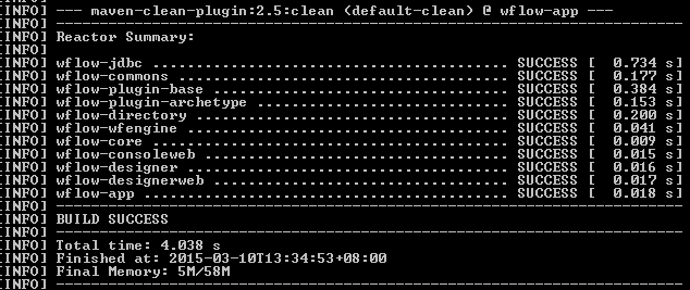

Hi Hugo,
MVN Clean
MVN Install
Still the same error.
I'm seeing the following.
A quick google suggests that you may have missing library. You may need the following library loaded into your maven repo - http://mvnrepository.com/artifact/backport-util-concurrent/backport-util-concurrent/3.1\\
I have tried to use maven 2.2 and 3.2.1 to build before without problem. What is your maven version?
You can also probably try to follow the video tutorial as well at https://www.youtube.com/watch?v=5k-mqaaT5RQ
Cheers.

Hi Hugo,
I installed the backport dependency but still no luck.
I am using:

I will just post my progress here in case someone would be also kind enough to help and for future reference
I reverted to Joget V3 and to maven 3.2.5
I have cleaned the mvn installation.
Installed the backport-util-concurrent, and the latest error is this:
Caused by: org.springframework.beans.factory.parsing.BeanDefinitionParsingException: Configuration problem: Failed to import bean definitions from URL location [classpath:commonsApplicationContext.xml]
Offending resource: class path resource [directoryApplicationContext.xml]; nested exception is org.springframework.beans.factory.xml.XmlBeanDefinitionStoreException: Line 13 in XML document from class path resource [commonsApplicationContext.xml] is invalid; nested exception is org.xml.sax.SAXParseException; lineNumber: 13; columnNumber: 6; The processing instruction target matching "[xX][mM][lL]" is not allowed.
I am currently tinkering on
wflow-commons\target\classes\commonsApplicationContext.xml
and
wflow-directory\target\classes\directoryApplicationContext.xml
changing the directory definition format inside the setupSessionFactory bean from
org/joget/commons/spring/model/Setting.hbm.xml (linux format)
to
org\joget\commons\spring\model\Setting.hbm.xml (windows format)
to
D:\joget\3.1-SNAPSHOT\wflow-commons\target\classes\org\joget\commons\spring\model\Setting.hbm.xml (full path windows format)
All attempts returned the same error.
Jaronloch
So it seems that Spring could not find classpath:commonsApplicationContext.xml thus failing to import it in line 11 of directoryApplicationContext.xml
<import resource="classpath:commonsApplicationContext.xml" />
Where can I find the value of the classpath variable? How will I be able to change or set it?
