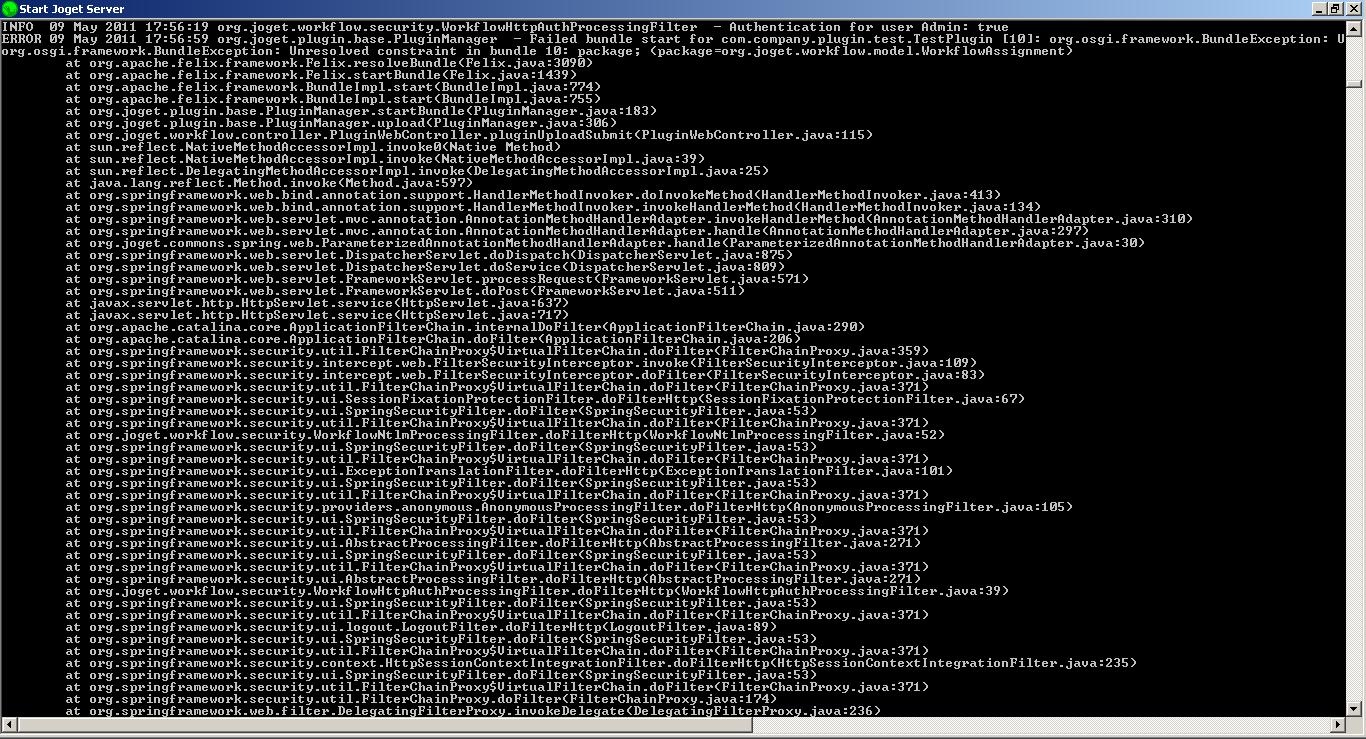

I just tried with WorkflowAssignment class for accessing the process details with a sample plugin, but Im getting java.lang.NoClassDefFoundError: org/joget/workflow/model/WorkflowAssignment in the line where the object is created for the workflow assignment class while the plugin is invoked during the workflow execution, So I tried to include the class in the POM file using the import package tag, in that case the upload of JAR is itself not happening and the below exception is thrown,
ERROR 09 May 2011 17:56:59 org.joget.plugin.base.PluginManager - Failed bundle start for com.company.plugin.test.TestPlugin [10]: org.osgi.framework.BundleException: Unresolved constraint in bundle 10: package; (package=org.joget.workflow.model.WorkflowAssignment)
Kindly let me know whether Im missing something here. I have attached the sample code MyPlugin.java and the screenshots invokeError.JPG, uploadError.JPG
Please help in this regard.

Vignesh Balasubramanian
I was trying different means to overcome the above issue, but nothing was helpful, Can someone help in this regards.
