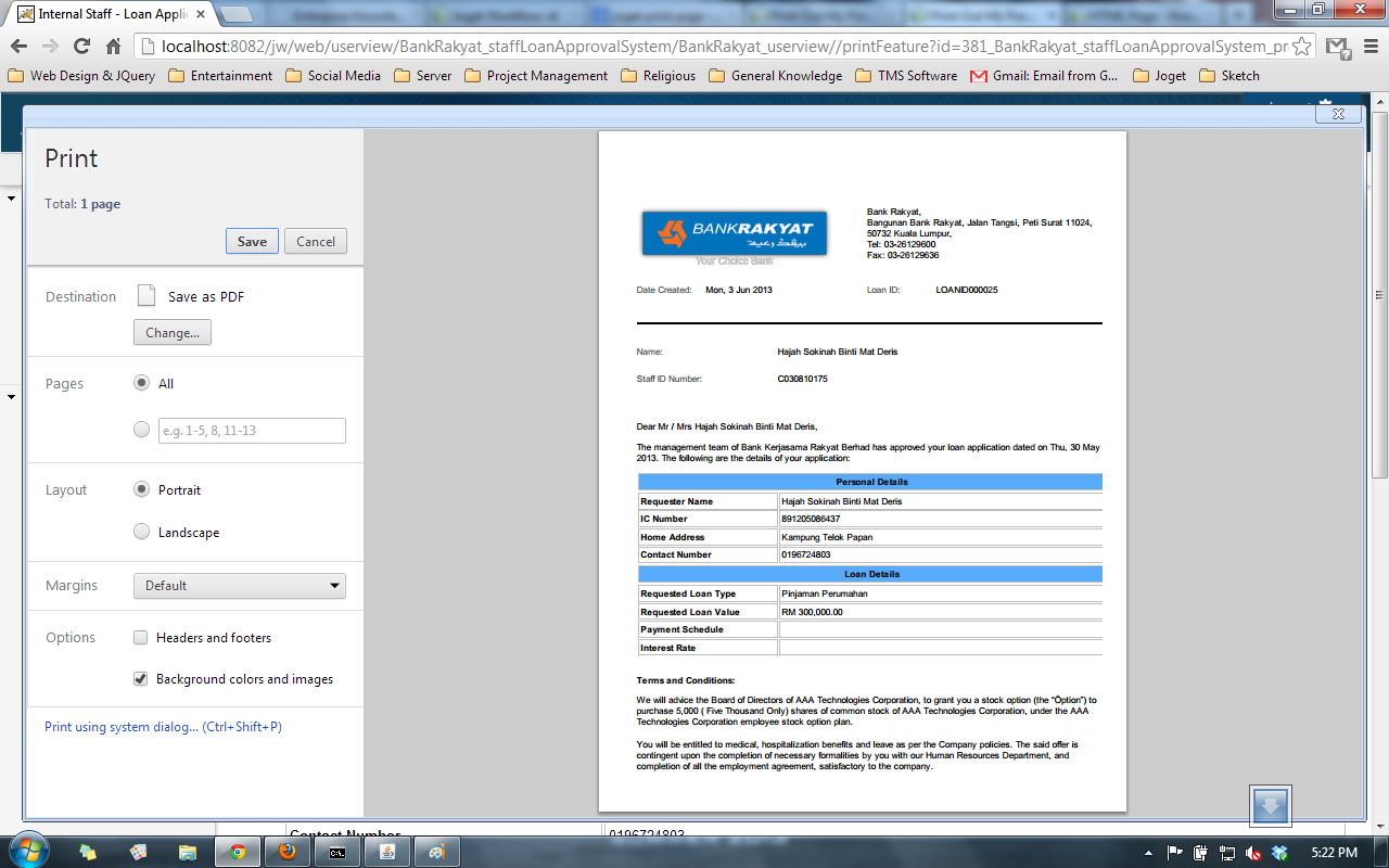

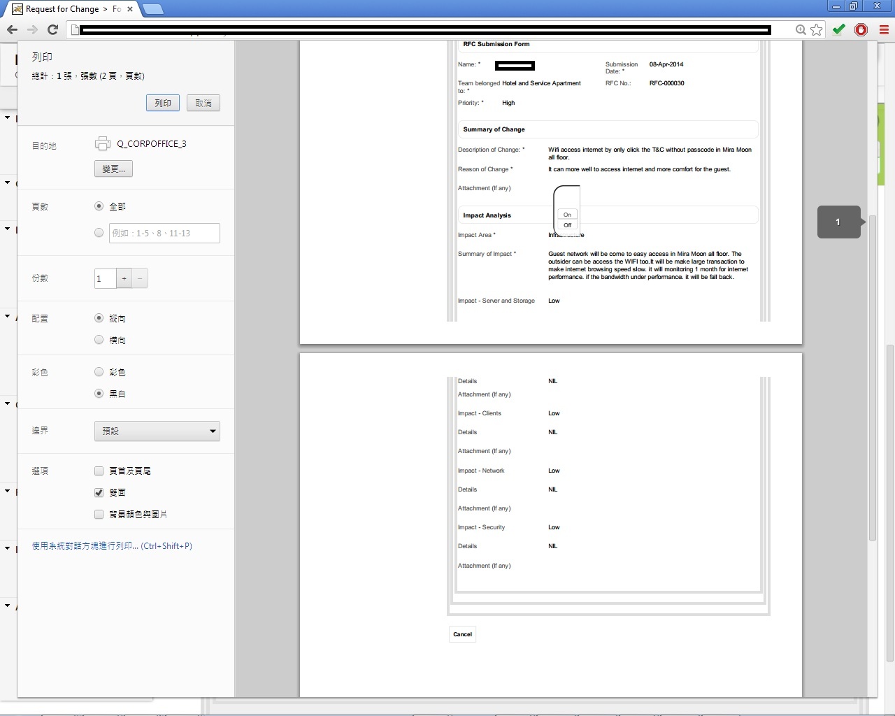

N Hafizi Kamaruzzaman
I have put design the print form in the application. The problem is only one page is printed. The balance of the page is not printed. Can you give the the solution on how to print the full content of the form?
As you can see, the signature is not printed, only 1 page is printed.
Thanks for your feedback. I will try to replicate this issue and update you again.

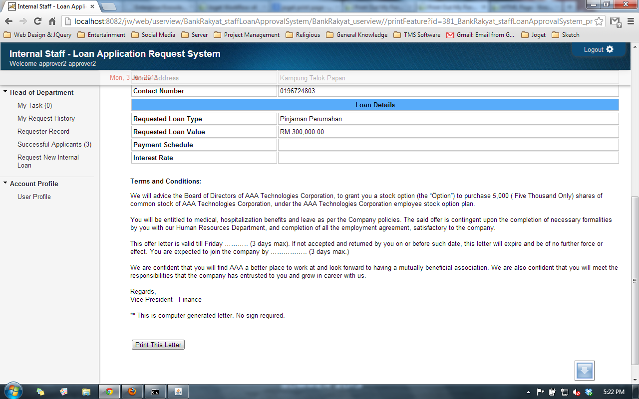

Gilbert Yu
When I try to print, everything just shift right and leave lots of blank space on the left. Sometime the Userview panel may shows up too. Could anyone help me and tell me what did I do wrong? Thanks!
Julian
Hi Gilbert,
It looks like some print issue in the Twitter Bootstrap CSS used in the theme you're using i.e. http://stackoverflow.com/questions/18974662/printing-twitter-bootstrap-correctly
Will need to look into the CSS to see what can be tweaked :)
