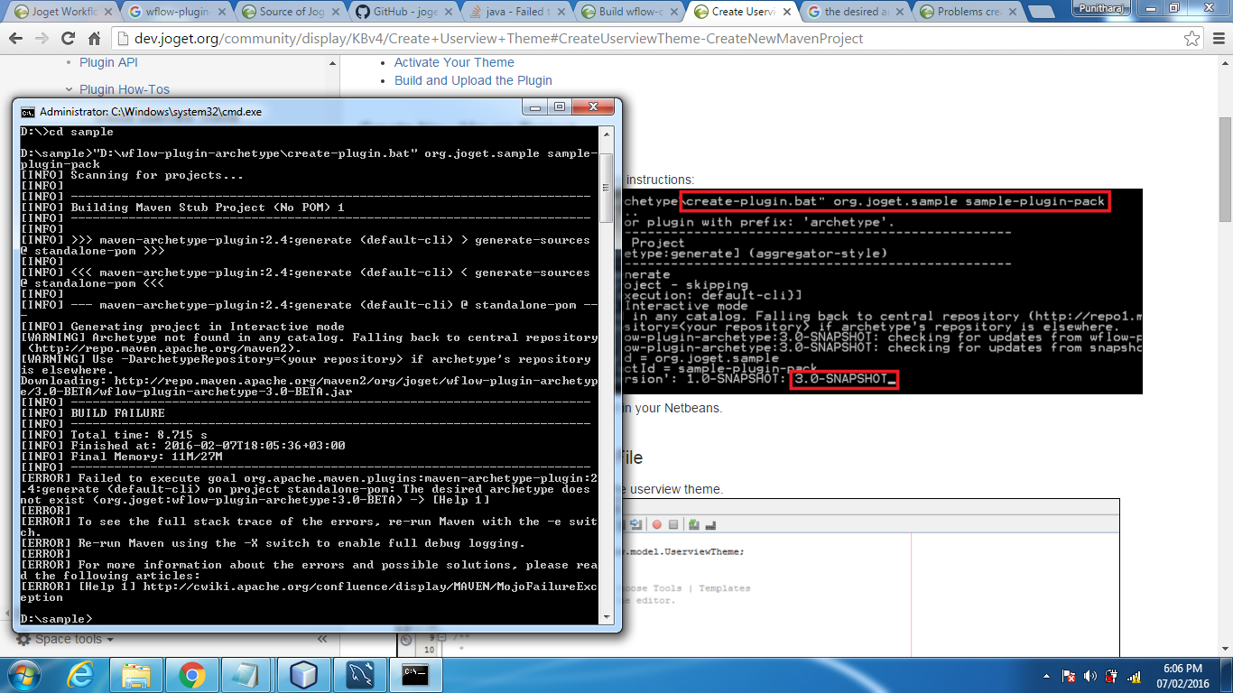

I compiled the JoGet from source and tried to create a test plugin, but It fails.
D:\Projects\JoGet_v3\wflow-plugins>..\wflow-plugin-archetype\create-plugin.bat com.company.plugin.test TestPlugin
[INFO] Scanning for projects...
[INFO] Reactor build order:
[INFO] wflow-plugin-beanshell
[INFO] wflow-plugin-email
[INFO] wflow-plugin-formDataEtl
[INFO] wflow-plugin-json
[INFO] wflow-plugin-report
[INFO] wflow-plugin-userNotification
[INFO] wflow-plugins
[INFO] wflow-plugin-referenceId
[INFO] wflow-plugin-mysql
[INFO] Searching repository for plugin with prefix: 'archetype'.
[INFO] ------------------------------------------------------------------------
[INFO] Building wflow-plugins
[INFO] task-segment: [archetype:generate] (aggregator-style)
[INFO] Preparing archetype:generate
[INFO] No goals needed for project - skipping
[INFO] [archetype:generate {execution: default-cli}]
[INFO] Generating project in Interactive mode
[WARNING] Archetype not found in any catalog. Falling back to central repository (http://repo1.maven.org/maven2).
[WARNING] Use -DarchetypeRepository=<your repository> if archetype's repository is elsewhere.
[INFO] snapshot org.joget:wflow-plugin-archetype:2.0-SNAPSHOT: checking for updates from wflow-plugin-archetype-repo
Downloading: http://repo1.maven.org/maven2/org/joget/wflow-plugin-archetype/2.0-SNAPSHOT/wflow-plugin-archetype-2.0-SNAPSHOT.jar
[INFO] Unable to find resource 'org.joget:wflow-plugin-archetype:jar:2.0-SNAPSHOT' in repository wflow-plugin-archetype-repo (http://repo1.maven.org/maven2)
[ERROR] BUILD FAILURE
[INFO] The desired archetype does not exist (org.joget:wflow-plugin-archetype:2.0-SNAPSHOT)
[INFO] For more information, run Maven with the -e switch
[INFO] Total time: 3 seconds
[INFO] Finished at: Mon Sep 19 17:35:24 AST 2011
[INFO] Final Memory: 18M/43M
Any help?
