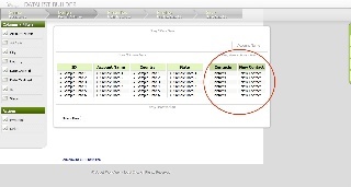

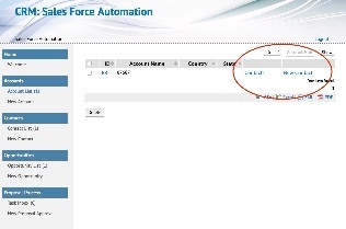

I am learning Joget and have some question about the provided example, CRM.
I don't understand the value in following fields;

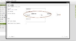

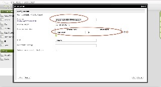

- In the Datalist section named "Account Listing", Column named "Contact", the value of Hyperlink , "contact_list?d-6304176-fn=account"
- In the Datalist section named "Account Listing", Column named "Contact", the value of Parameter Name, "d-6304176-fv"
- In the Datalist section named "Account Listing", Column name "New Contact", the the value of Parameter Name, "fk_account"
I want to do the link in Datalist as I see in the CRM example. But I don't understand the value in these fields. Could anyone explain or provide the link that explain these value?
Thank you in advance.

For each filter added in the Datalist Builder, an unique identifier will be created. In the case of yours, its "d-6304176-fv".
In New Contact link, the "fk_account" is used to prepopulate the target form with the account information.
Hope this helps.
