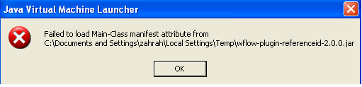

Zahrah M.Razak
I tried to install refID and email plugin but to no avail. Is there any special requirement to install that plugin?
Message appear:
Tiensoon
Hi, sorry but I don't think you are installing it the correct way. In fact, the all default installers and packages of Joget Workflow downloadable from our official sites, come with Reference ID Plugin and Email Plugin as standard installation. In the Workflow Management Console, you can look at the list of plugins you have, by navigating to Settings > Manage Plugins.
