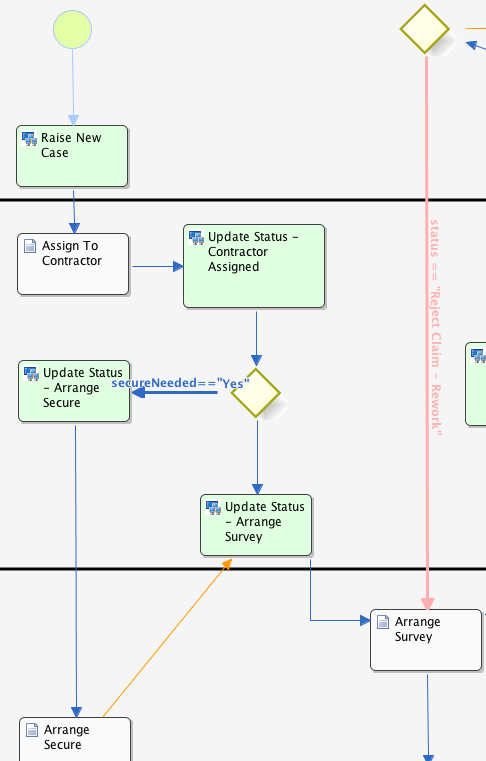

I'm having major problems reassigning tasks from one user to another. I have the following setup with a new task being created, passed to the management team and then assigned to a contractor for the work to be done.
New Task --> Assign Contractor --> Contractor carry out work.
My problem is that once assigned to the management team I cannot reassign the task to a contractor. I've been able to use the following code in the first assignment to programatically assign a number of users, but this fails in the second attempt to assign a contractor.

Hugh B
Thanks Julian.
The first assignment is carried out through a beanshell script which allows me to check this is working. Admin2 is a fake name but the beanshell tool adds it okay and works as expected. This also works with all the other types of assignments and will (in the live server) assign to a group.
But for testing, the beanshell added both Paul and Admin2 to prove I had control.
The problem I now have is that if Paul picks up the case and assigns it to a contractor, it does't change the list of Pending, meaning only Paul can pick the case up.
I've attempted to set this assignment through a number of ways:

Here is the process.
