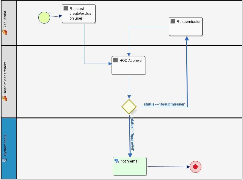

Hellow,
I'm beginner user Joget workflow. I finished my first process following the instructions on the website and youtube. But I'm having two problems:
01. When Head of Department click on the button "complete task" the screen don't close;
02. When the requestor receive a not approved form to resubmit and make changes pointed out by HoD, the changes pointed by requestor don't arrive to HoD for approve again. What arrive is the first form request made by requestor. I had already placed subform in resubmission form but I can't do it.
I'd appreciate if someone can help me.
I attached drawing the diagram of the workflow. The Workflow is to control creation/exclusion of users.
Best regards, Thanks.

Hugo
Hi there,
Is there any error in the server console? Or maybe you can export out the package, put it in the forum so that we can import it in into our Joget to troubleshoot it for you.
Just an extra note, remember to make sure of workflow variable when there's routing involved!

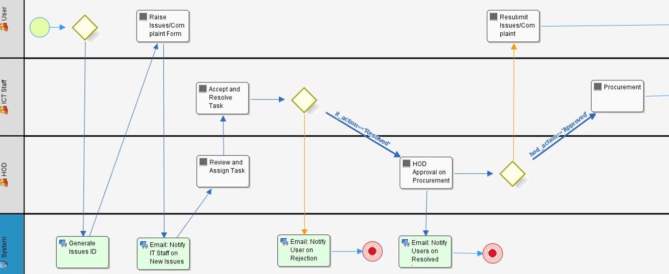

Hi,
I am also newbies in Joget Workflow. I am doing Helpdesk System and managed to create forms for each activity and try to link between each other. Below is my system workflow:
1) When User finished fill in the form and click the 'Complete Task' button the screen won't closed. Why?
2) What configuration should i do if i want user to fill in the data, click 'complete task' and then system will send email notification to HOD to 'Review and Assign Task'. Then HOD will get the link to open the complaint detail and assign task to specific technicians.
I try to follow the The Travel Management sample but still could not find any solution. Can you help me?
Hugo
Can you check if there's any error in your server log?
In your form input value, key in the specific technician's username then map it to a workflow variable. Then, in the participant mapping, you can use workflow variable to map to the participant 'ICT Staff'.
Hope it helps!
Pinky
Hi Hugo,
1) If I not mistaken i do not sees any error in the server log.

2) Your Answer:
Does it means that i need to create a technician's name ex: 'Ali' as workflow variable in Workflow designer then assign it in the form field?
Sam Choo
Hi Noorhayati,
(1) Your log seems a little short to have had logins and process starts. Did you copy the entire log history to the exact time you experienced the 'stucked submission' screen?
(2) In Participant mapping, there's an option to map the participant to a 'username'. Hugo had suggested that you create a workflow variable, eg. 'technician_username', and in the form that the HOD fills in, the HOD will fill in the username of the technician who he wishes to assign the task to. Then, in the subsequent activity, the Joget will be able to select the participant to assign it to. Of course, you can use Form Variables to populate a pull down list of technicians, based on their group membership. An example explanation here: Re-assigning an Activity to A Specific Participant You will have to use a BeanShell script to obtain the list of your users in Form Variables. I've got an example for you below:
You can read up more on Form Variables, and how to use this in your forms from the knowledgebase.
Hope this helps.
