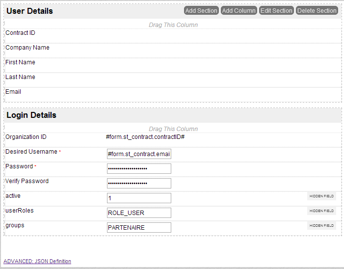

This is user registration form. To use the “Directory User Form Binder”, I’ve embedded it as a sub-form in another form.

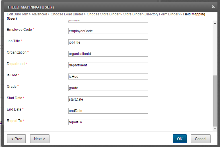

I’m able to assign the user to groups. The id of the “Organization ID” is organizationId that maps the setting in the field mapping part shown below

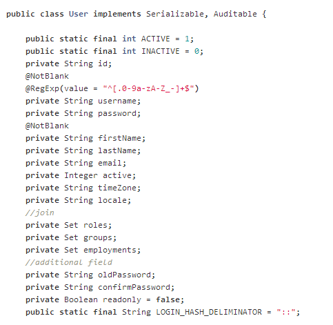

And I’ve also check the User model (shown below) where the “organization” seems to belong to the “employments” field.
But here comes the core question, how could I map the organization to the User model where it only has “employments” field?

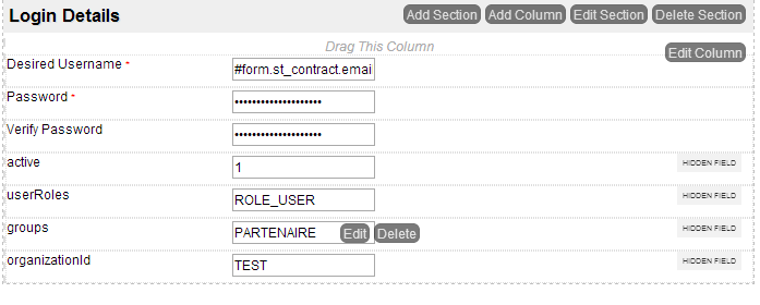

It's so glad to know that at least you're able to do this. I've wondered that as well, so I've tested an static org id as "TEST", but it doesn't work for either.
And may I know the id of your "readonly text field" and type of value you've passed? Is it "organizationId"? The org id you've used, it is all numeric or all alphabet or alphanumeric?

Jianan SU
Here is the latest file i've tried.
THXXXX!!!!! =)
