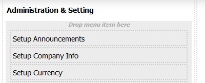

First let's say I have this category and menus :

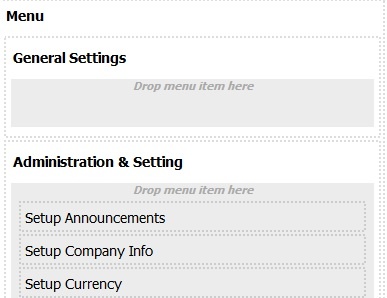

Then I add new category

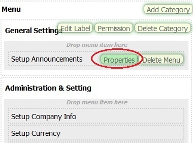

And then I try to move "Setup Announcements" menu to the General Settings category
Here the first problem appeared, I can't click on that menu's properties, meanwhile the other menus are perfectly working fine.

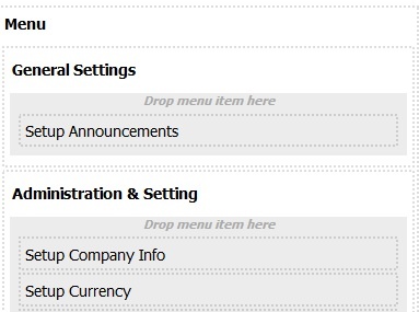

Then when I try to force save this design, the Setup Announcements menu will disappear from general settings category and nowhere to be found in Administration and Setting also.
