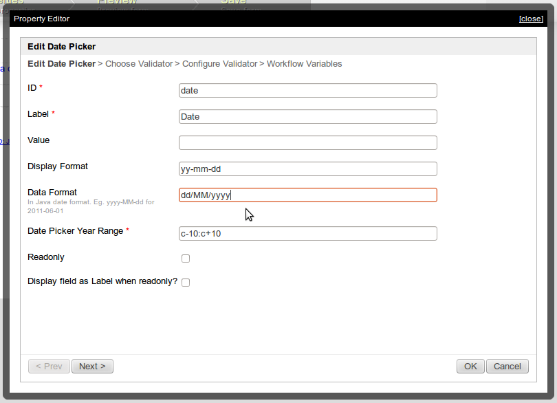

Hi Hugo,
I read Owen's article and I wonder what has become of the following Date Picker Property Editor in the article.
Since it contains the fields "Display Format" and "Data Format".
In my Joget version I only have one field "Fomat"?
Cheers
Hi Joost,
You may need to update your local Joget copy to the latest available one as this may be a new feature added in recently. This set of properties is available in your cloud account though.
via mobile
Joost van der Schoot
Hi Hugo,
Yesterday I downloaded the last version, but that is the same build as I am using now, so probably there is no build yet with this feature?
Regards, Joost
Julian
Hi Joost,
This feature is in the v4 beta. It's also in the the newer v3.1 builds. We've not released any new v3.1 builds to the community yet, but they are available in the enterprise support site.
Regards,
Julian
