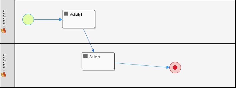

Plugin (Tool) must be placed within a participant of "system" type. So, there's no need to perform participant mapping on system participant. You may refer to http://java.dzone.com/articles/prototyping-workflow-driven, Figure 1.7 for a sample screenshot

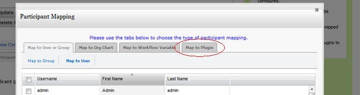

Mapping to a Participant Plugin allows us to programmatically determine the user(s) acting on this participant. So, if you map a participant to BeanShell Plugin, then we can use scripting (which is essentially using Java syntax) to return a list of users, identified by username.
Example:
import java.util.*;
// some logic to determine users
// return usernames in a Collection
Collection users = new ArrayList();
users.add("clark");
users.add("cat");
return users;

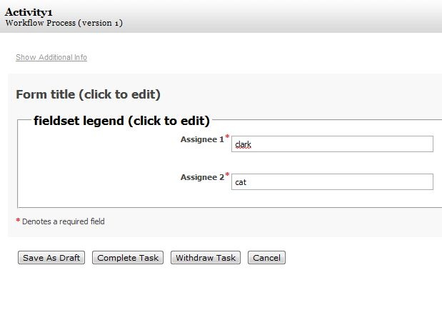

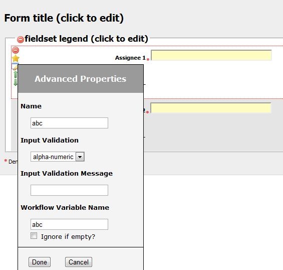

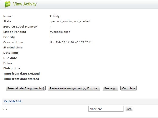

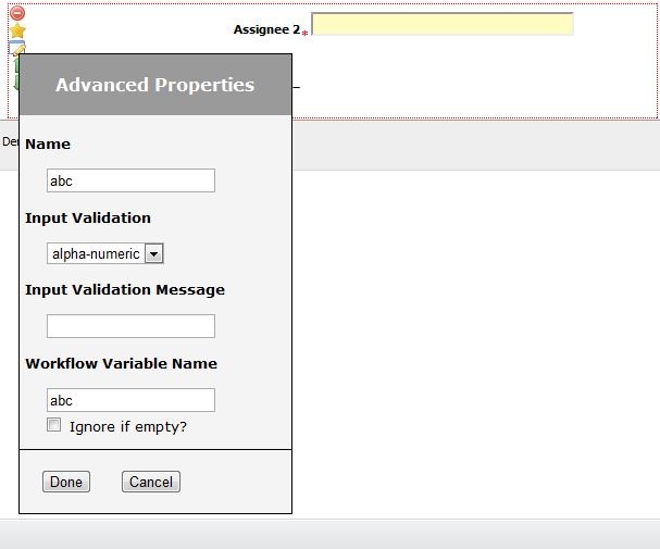

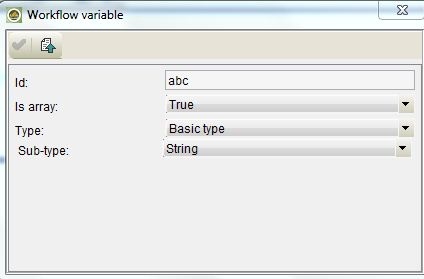

When the multiple values selected from checkbox is set to a workflow variable, the workflow variable value will be set as something like "username1|username2" (without quotation marks).
Using BeanShell Plugin, you would be able to access the workflow variable value, using Hash Variable, such as:
String usernames = "#variable.assignees#"; // in this example, usernames would be username1|username2
Then in the BeanShell script, you can use java.util.StringTokenizer to split "username1|username2" into "username1" and "username2". And subsequently set the individual username to a Collection object

I refer to Participants Plugin, when I am mapping a participant to package level.
Tiensoon

Ferdiansyah Dolot
Hallo Mr. Tiensoon, this is my java code :
import java.util.*; Collection list = new ArrayList(); String usernames = "#variable.abc#"; String delimeter = "|"; StringTokenizer str = new StringTokenizer(usernames, delimeter); while(str.hasMoreTokens()){ String temp = str.nextToken(); //System.out.println(temp); list.add(temp); } return list;I used this code to map multiple participant like you've suggested before.
My workflow design and the result can be seen below
And it still failed (by the value of 'List of Pending' above).
Any mistakes that I made? How can I solve my problem?
Thanks for your help. :)
Tiensoon
Hi Dolot,
Sorry, I've forgotten that the BeanShell Plugin has limitation using some Hash Variables, when BeanShell is used as Participant Plugin.
Please try using Java API to get the workflow variable value. I have modified your codes to this:
import java.util.*; import org.joget.workflow.model.service.*; Collection list = new ArrayList(); WorkflowManager workflowManager = (WorkflowManager) pluginManager.getBean("workflowManager"); String usernames = workflowManager.getProcessVariable(workflowActivity.getProcessId(), "abc"); // get workflow variable value using Java API String delimeter = "|"; StringTokenizer str = new StringTokenizer(usernames, delimeter); while(str.hasMoreTokens()){ String temp = str.nextToken(); //System.out.println(temp); list.add(temp); } return list;infiniti
