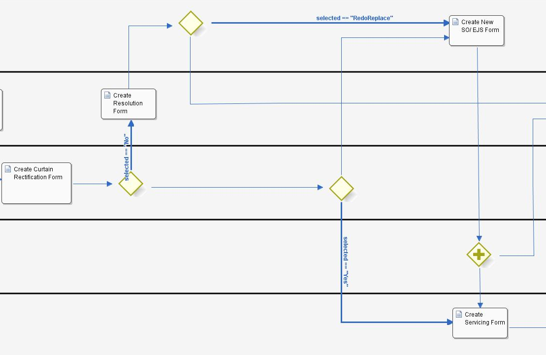

Can anyone tell me, why "create resolution form" not show but straight away jump to "create New SO/EJS Form"
Now, the "create resolution form" is show, but the "create New SO/EJS Form" didn't show.
Help please.
Regards,
Suliss
Make sure that every transition is handled and not left un-configured. Think of "resistance" like water flowing.
After "Create resolution form", it will flow to transition with lower resistance.
better way to set as *otherwise condition *to un-configured transition.
It's okay already the design. I use otherwise :) Thanks all !
