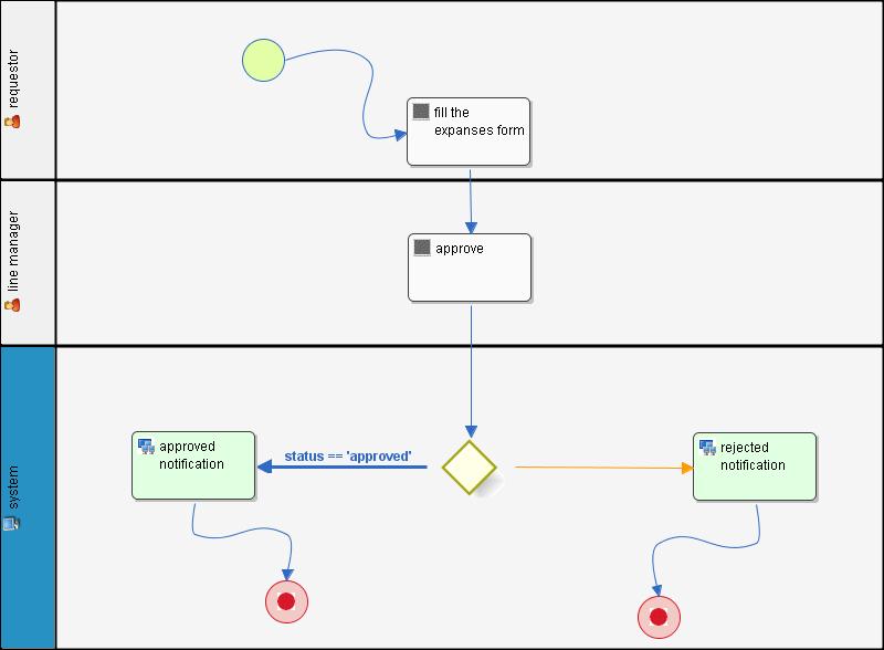

here is my process's graph :

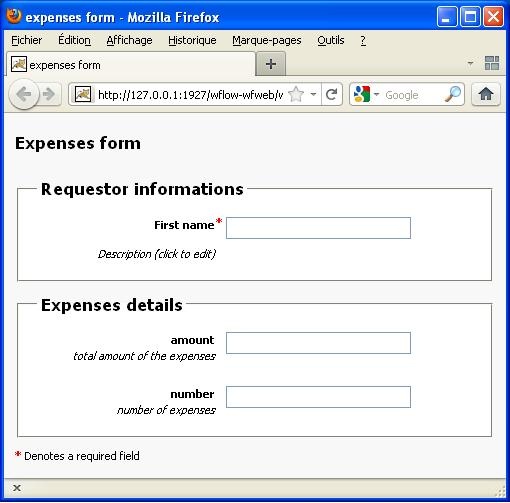

here is the expenses form :

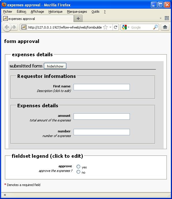

and here is the approval form :
I assigned the "expenses form" to the "fill the expanses form activity" and the "approval form" to the "approve" activity.
I also included the expenses form as a subform in the approval form, as explained in the tutorial but when I run the process, the subform happens to be empty...
