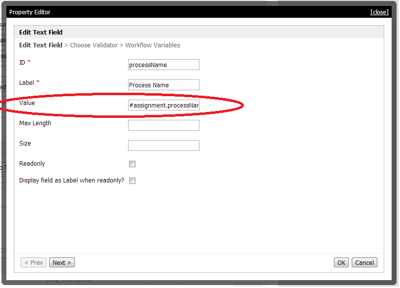

You probably want to use a Hash variable. Set the value of your field equal to #assignment.processName#
dark devil
it doesn't works.
can you post a visual example to guide me.
I'm on the lookout.
thanks again

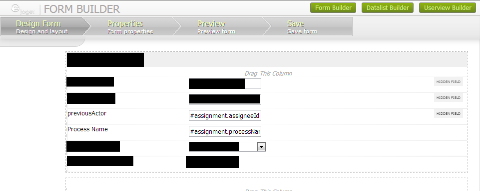

Pete
Add a new text field with the hash variable as the value.
It will look something like this in the Form Builder.

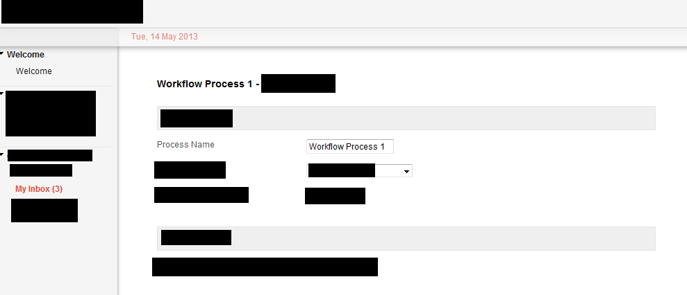

Save the form.
When you go through your process, the form field will be updated with whatever the value in the hash variable is.

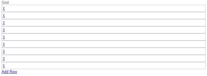

Ok. look this. I have 9 users in my dir_user table and I put the next code in the Configure Bean Shell Form Binder
import org.joget.apps.form.model.*; import org.joget.apps.form.service.*; import java.sql.*; import java.util.*; import org.apache.commons.collections.SequencedHashMap; Connection con = null; Class.forName("com.mysql.jdbc.Driver").newInstance(); con = DriverManager.getConnection("jdbc:mysql://localhost:3306/jwdb?characterEncoding=UTF-8", "root", ""); FormRowSet f = new FormRowSet(); f.setMultiRow(true); if(!con.isClosed()){ PreparedStatement stmt = con.prepareStatement("SELECT * FROM dir_user"); ResultSet rs = stmt.executeQuery(); while (rs.next()){ FormRow r1 = new FormRow(); r1.put("gridColumn1", rs.getString(1)); r1.put("gridColumn2", rs.getString(2)); r1.put("gridColumn3", rs.getString(3)); f.add(r1); } } return f;The image below show the code result.
as you can see there are 9 rows, the same quantity than users (dir_user table), but it doesn't show me the columns names with the information.
Can someone tell me where I'm wrong?. I think the nex code
isn't correct but i don't have idea of another way.
