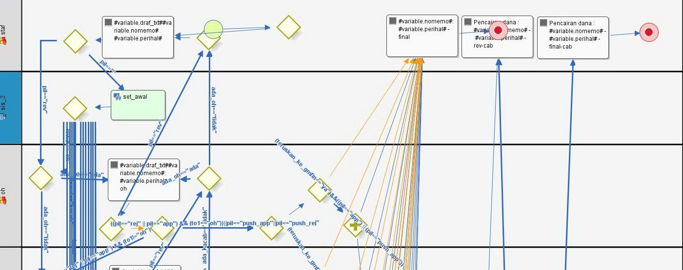

this event cause i use subflow on my workflow
the workflow look like this
then subflow represent the workflow :
i dont know where the error come, because of the complex of the workflow or i just have made a mistake to set the workflow...

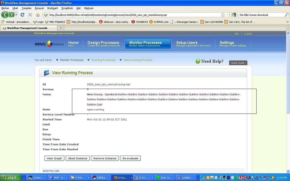

the result of this error, that setting make lopping to create assignment, that i can see in running process,
so how can i fix this.

ario sadewo
the problem is solve, i just has miss configure subflow id into correct parent workflow id
