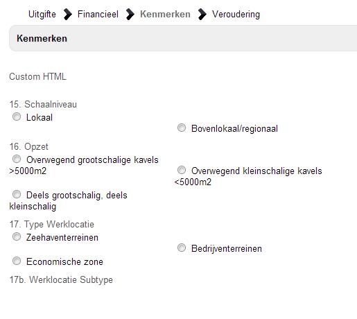

here is an example http://jsfiddle.net/kmzS2/3/
I have a piece of Joget like generated radiobutton html fragment there together with javascript to add br elements behind the labels.
when the script is running it puts br elements behind the label elements around the radiobuttons.
This scripts works in jsfiddle. But in Joget app environment each radiobutton is oriented left and right.see here: Jogetradiobuttons.jpg

Hello Again,
I found a solution: extra styling is needed.
I attached a note with the script and CSS to create all radiobuttons vertical.
verticalradiobuttons.txt
Cheers, Joost
