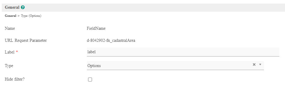

you can set the type to options

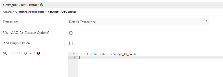

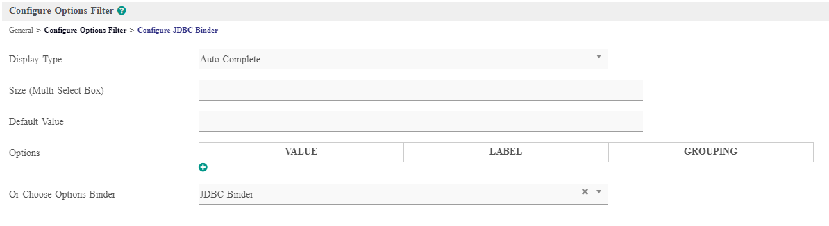

and set option type to autocomplete and binding option to JDBC option
Then write your own query (usually value and label are the same ex: select c_name,c_name from app_fd_employee)
Thanks Issa. It works good.
