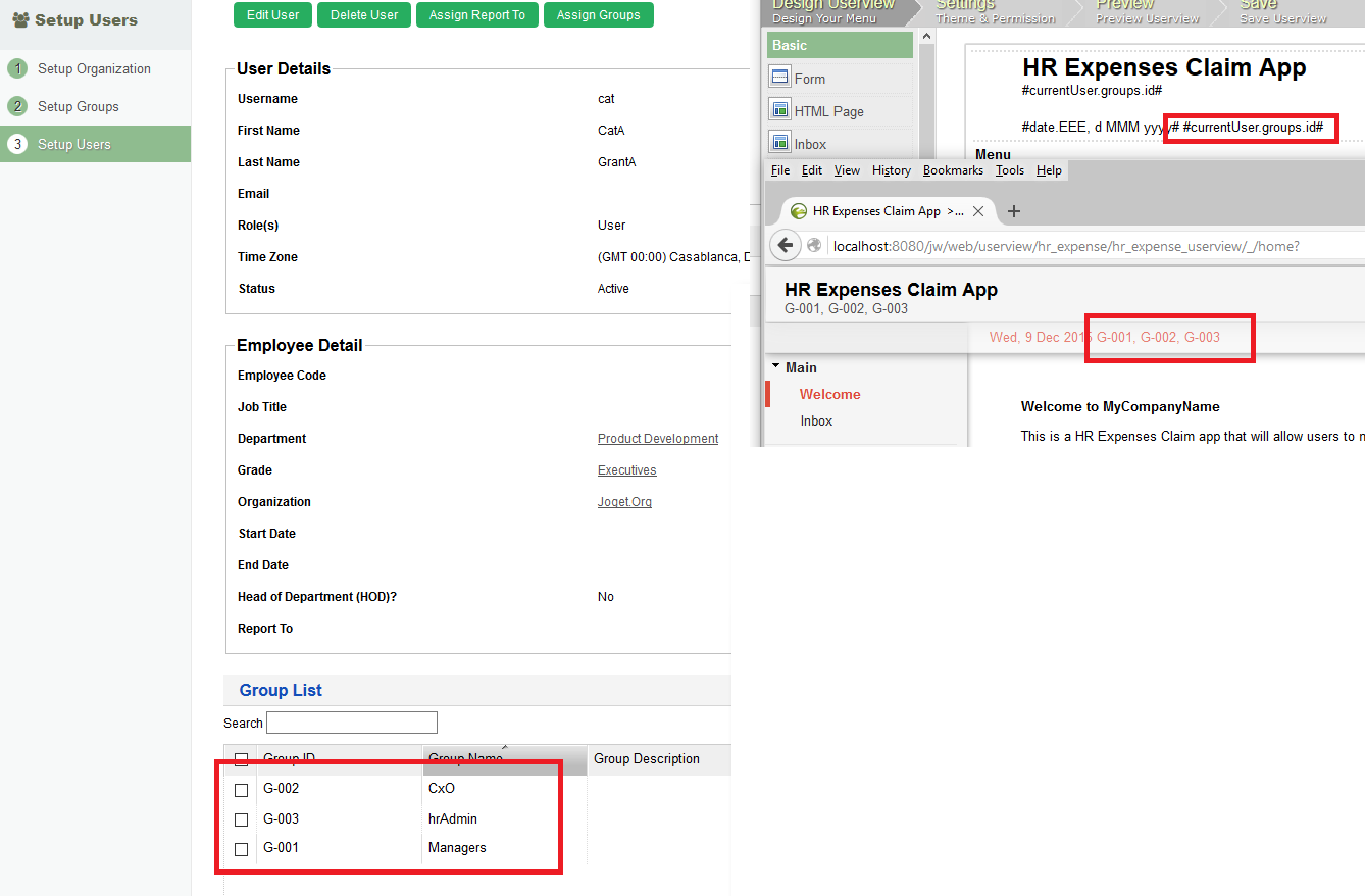

The extended currentUser hash variable does not grab the group id when used (#currentUser.groups.id#)

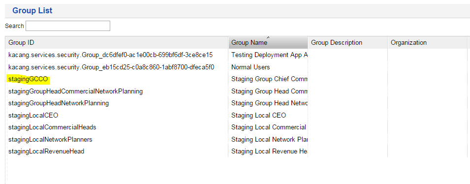

Please advise on how to grab a specific group ID from screenshot below. Thank you.
Hey Kuhan, What are you getting instead? If a user belongs to multiple groups, probably you will get it parsed as "group1;group2;group3". We cannot choose which to and which not to get. Cheers.
Hi Hugo, I'm getting an empty string as the value.
