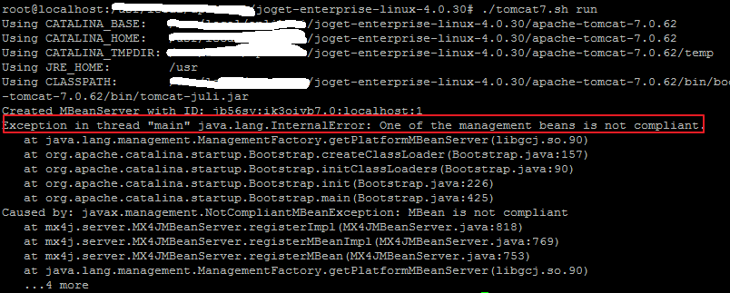

Very strange error, even googling did not have much results. Suspect could due to Java version? Perhaps try installing a new Java 7 or 8 and see.
Thank you Anders,
you are right, you spot on my problem. I don't notice my jvm path point to 1.5 version. Now it's up.
I'm trying to install joget in Redhat EL linux, and follow the steps in installation instruction. While starting the server I got this error message and the app server failed to start.
What is the problem here?
Exception in thread "main" java.lang.InternalError: One of the management beans is not compliant.
at java.lang.management.ManagementFactory.getPlatformMBeanServer(libgcj.so.90)
at org.apache.catalina.startup.Bootstrap.createClassLoader(Bootstrap.java:157)
at org.apache.catalina.startup.Bootstrap.initClassLoaders(Bootstrap.java:90)
at org.apache.catalina.startup.Bootstrap.init(Bootstrap.java:226)
at org.apache.catalina.startup.Bootstrap.main(Bootstrap.java:425)
Caused by: javax.management.NotCompliantMBeanException: MBean is not compliant
at mx4j.server.MX4JMBeanServer.registerImpl(MX4JMBeanServer.java:818)
at mx4j.server.MX4JMBeanServer.registerMBeanImpl(MX4JMBeanServer.java:769)
at mx4j.server.MX4JMBeanServer.registerMBean(MX4JMBeanServer.java:753)
