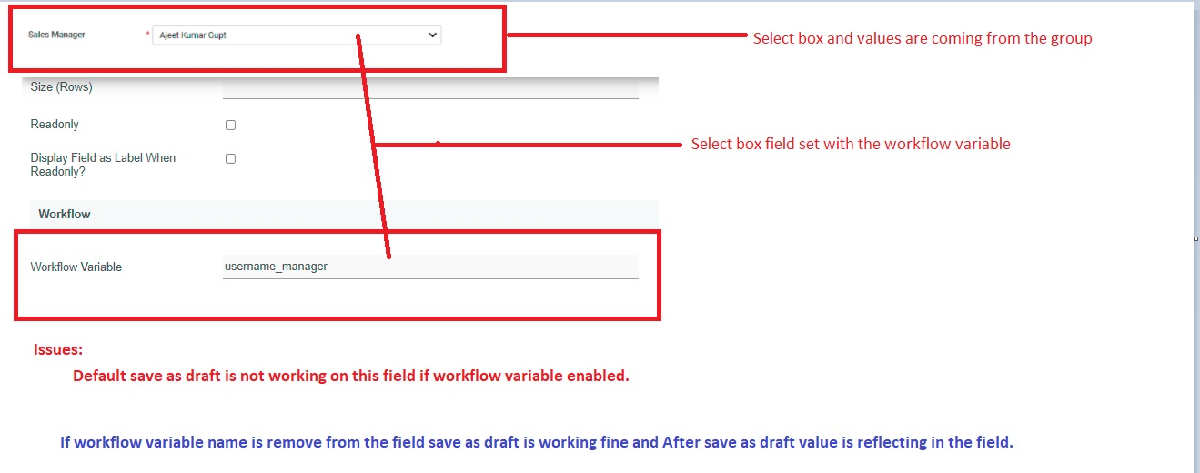

Thanks for the response. I am using the run process save as a draft.
Hi Team,
I am getting the issues in my joget app. We have created the workflow and by default set the Save as Draft features on the form. On this form one select box and in this select box values are coming from the Group and this select box is set with the workflow variable. After Save As a draft, the value is not reflecting but in the database, the value is saved. For more information please find the attached screenshot.
