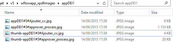

From the screenshot, the path xx\v5\wflowapp_xpdlImages does not seem correct and is missing a slash (\) in between. Did you set a custom wflow.home in your startup script? You will need to ensure that there's a trailing slash in the path e.g. xx\v5\wflow\

I have installed Joget v5 on our server and everything is fine except that Process thumbnails keep refreshing. In fact, here is what I get :
It keeps refreshing because it deletes and creates thumbnails untill I quit the "process webpage" or if the web browser crashes. I have already tried each step of this page : Process thumbnails not showing without success.
The problem here is not that images are not created but it is an infinite loop.
