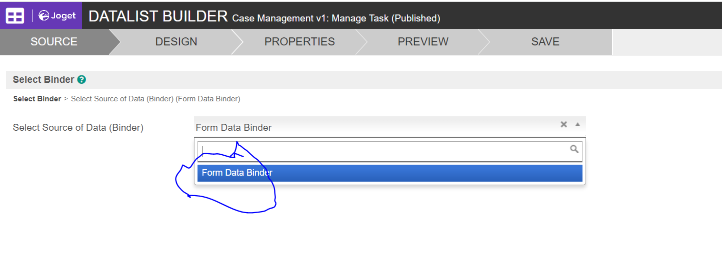

If not the code for the JDBC Datalist Database Binder, is the the jDBC Datalist binder available in community version or you meant that this plugin itself is not available in community version ?
Reason I am asking is, I have a user chase where-in a Manager assigns a task to employees. Now when an employee logs in he/she should see the tasks assigned only to the employee and not all the tasks. Currently when I use Datalist form binder it shows all the tasks to whoever logs in. So i thought might be jDBC Binder would help where-in from the workflow variable I can pass a user-id(employee-id) to get list of tasks assigned only the logged in user. Or if you can suggest how this scenario can be handled in community version please ? I am currently using version 7, very new user of joget.
