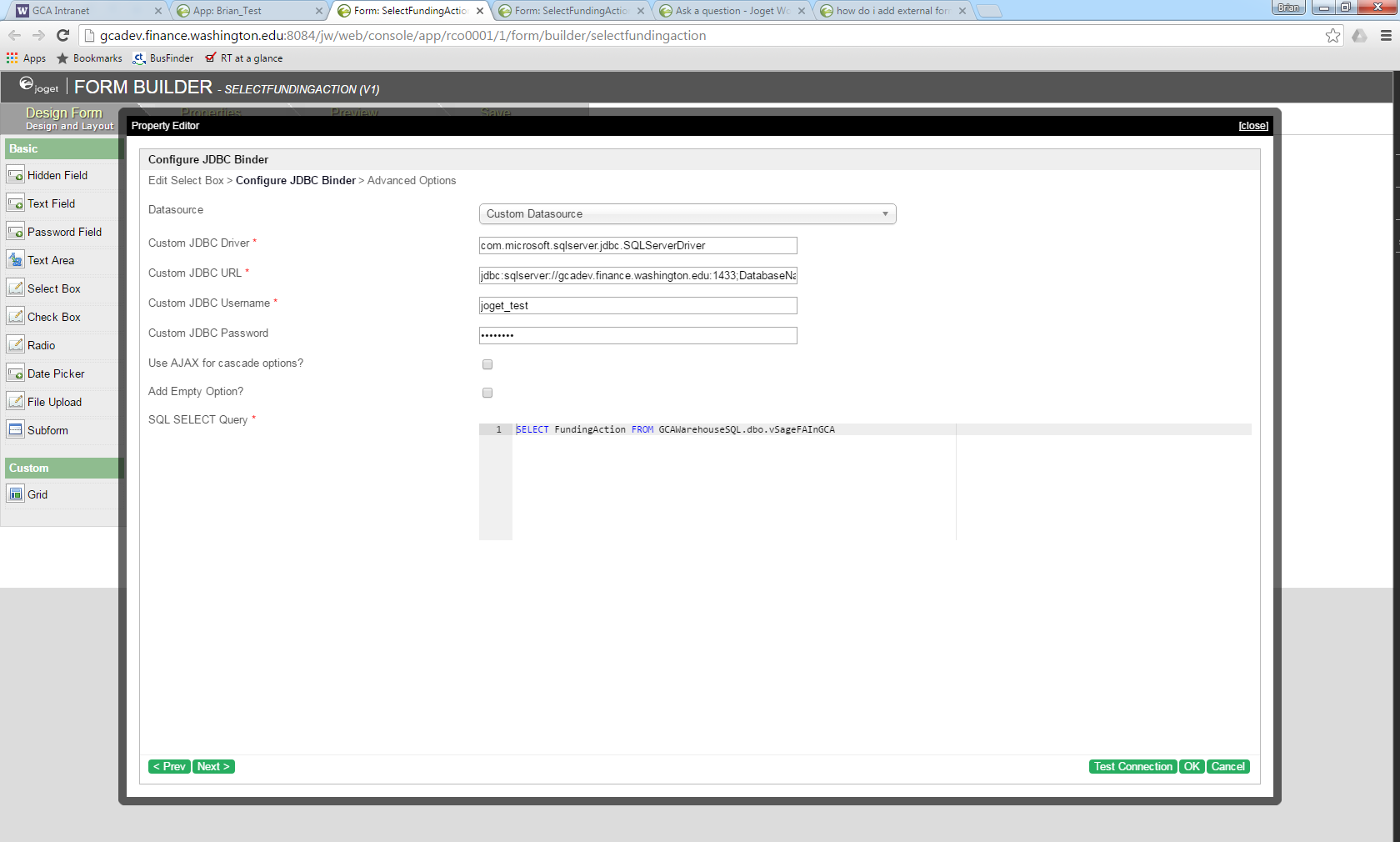

Before: SELECT FundingAction FROM GCAWarehouseSQL.dbo.vSageFAInGCA
After: SELECT eGC1_Number AS ID, FundingAction FROM GCAWarehouseSQL.dbo.vSageFAInGCA

To populate a selectbox, you need two values, the id and the value, example:
"select id, firstName from database_name;"

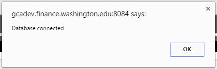

I am trying to populate a dropdown list from an external database view (MSSQL) using the JDBC Binder plugin.
I am able to create a database connection and test with success, but when I run the form the dropdown is empty.
Am I missing a setting?
