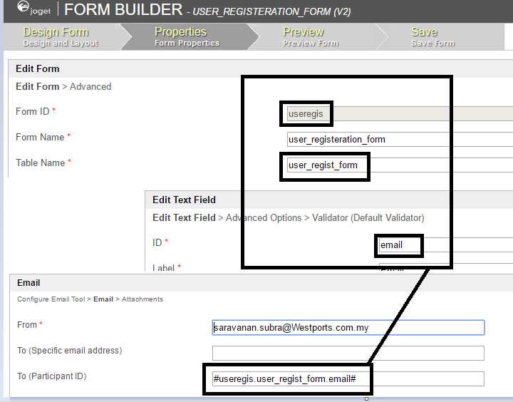

As panda said, the hash variable should be #form.user_regist_form.email#, and since it contains a specific email address it should be in the "To (specific email address)" field instead of the "To (Participant ID)" field.
it should be #form.user_regist_form.email#. the "form." is a prefix that u should not change it.
Hi Even I change and put this command #form.user_creation_form.email# , still haven't get the approval notification There are 3 form : a.user_registration_form b.user_creation_form c.user approval_form I not sure which tablename from this 3 form need to add in mail settings

it should be table name not form id or name. u can refer to Hash Variable.
#form.TABLE_NAME.FIELD_ID#
Hi, I set the mail using table name : #form.user_creation_table.email#, still no mail coming in https://westports.cloud.joget.com/jw/web/console/app/lxe_tracking_system/2/form/builder/user_creation_form#
I try below way as per advice, but still there is no mail notification received
