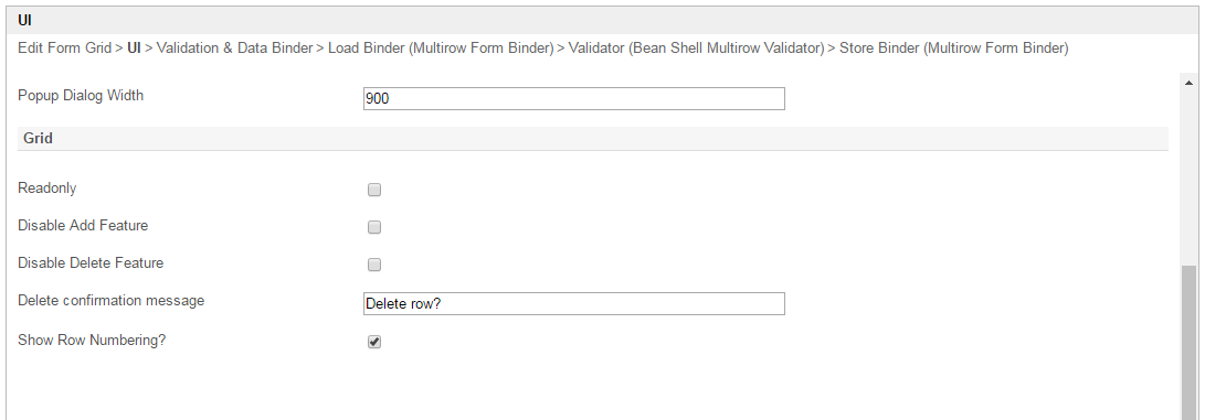

On the same page, scroll up to the top. Look for Enable Sorting Feature and Field ID for Sorting (Form Grid).
1. Enable the sorting feature.
2. Key in a field ID to store numbering.
3. Go to the child form, create a hidden field with the field ID from #2.
Oh, thank you very much.
I want to save "row numbering" to database
