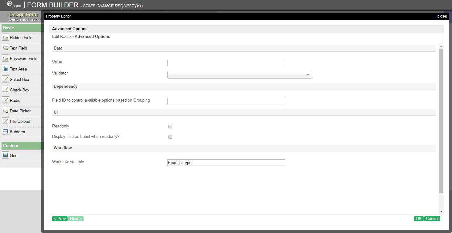

Anyway, to answer your question if the form variable and workflow variables for the transition are same, I think they are same based on the screen shots attached below. So, I'm still clueless as to how to make the transition go to one of the approvers. Right now, the Submit Request activity only is highlighted in yellow, meaning active.

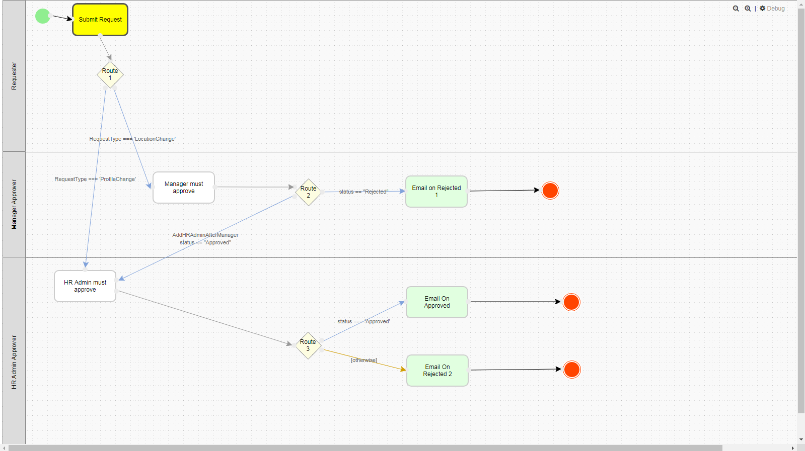

Hi, it looks like the transition condition is not met, so the process did not proceed to the desired activity. Did you map the value of your approval form field correctly to your workflow variable? You will need to make sure the exact workflow variable name used in the process matches the one mapped in your form element.
Also, what happens when the condition is not met? You should have Otherwise transitions from your route to handle this flow.

I'm new to Joget Workflow and I'm in the process of trying out the Cloud version to come up with a very simple prototype that would generate a workflow of approvers based on the value of a radio button field on the form.
Either in the "Run Process" view or through the actual submission of the form, I'm not able to see the workflow being assigned to the first approver. The process is in the Submit activity and does not progress to the route or the next activity.

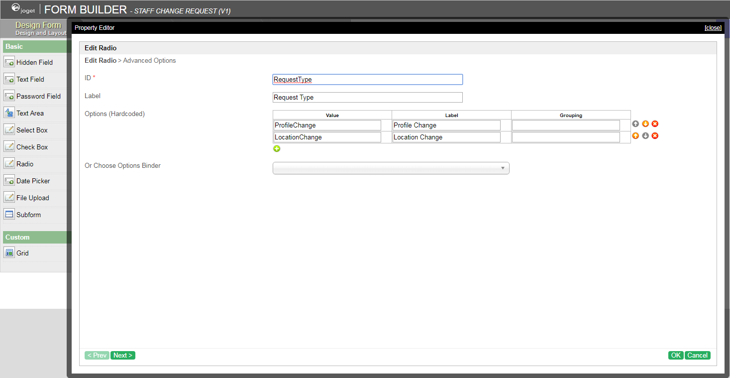

My form has a radio button called - Type of Request with 2 values; ProfileChange and LocationChange.
For the scenario of the workflow generated in the attached screen shot below, the option "ProfileChange" was selected and I was expecting the process to be on the HR Admin Approver activity. But, that does not happen.
