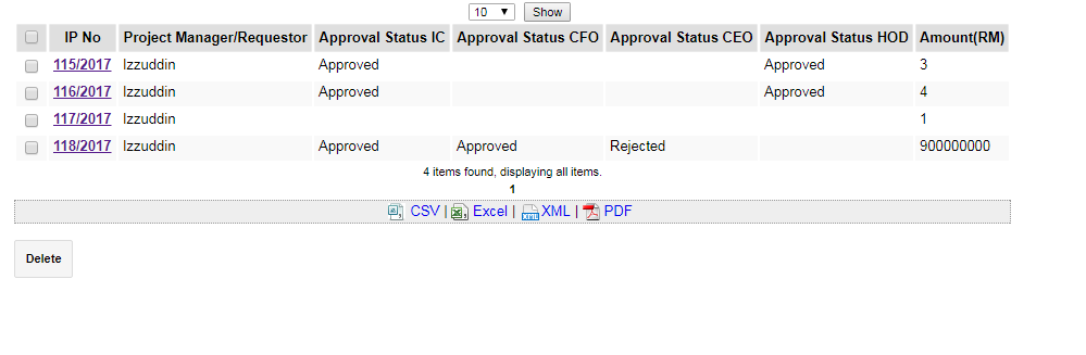

Hi, I need a help,
Currently I'm using Joget Community version. Figure above is a datalist for submitted request (more like the status), how I want to make the requestor can only see their own request. For example, IP No 119/2017 is a different requestor, so only he can see the request and can't see the other request like the figure above since those are from another requestor. Need help on this. Regards
