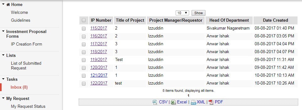

1) I have many head of department, how to make the activity can only be seen by the specific approver. For example, the approver is Anwar, so how to make only he can see his activity. So he won't be able to see the Sivakumar's

Hi, I have a question to ask. I'm using joget community version and figure above is customized inbox that I created. Basically above Inbox will display the activity for approver to approve the request. For example, if the approver click at IP Number, it will link to the approve request form. Here are the question;
2) How to delete the IP Number once the IP Number has been approved.
(Number 1 is most important)
