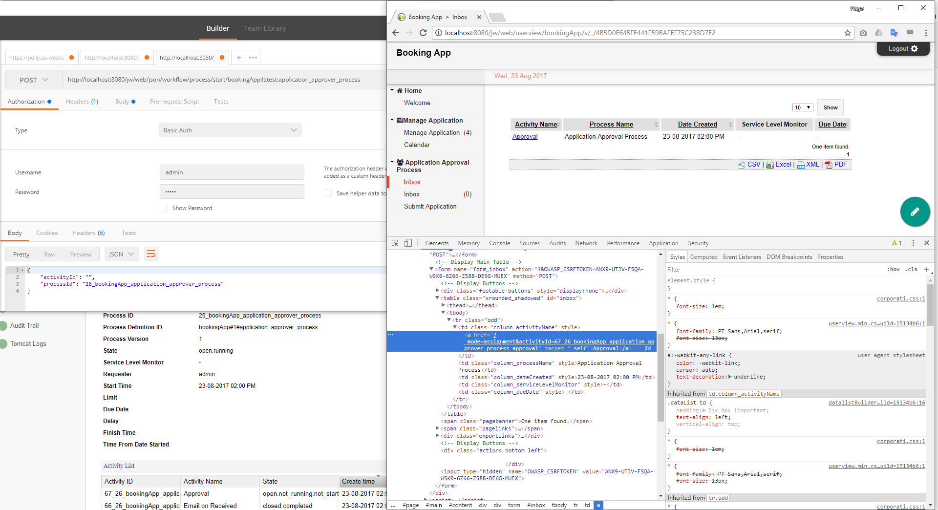

Hi Seth,
I have just tried to follow the steps and able to see the assignment created as a result of starting a process instance via API. Please see the screenshot of mine.
I can see the assignment created in Inbox in the Userview. If you are using Datalist Inbox, you may not see it until you have a form record row created for the process instance. Starting a process instance by itself will not create a record row.

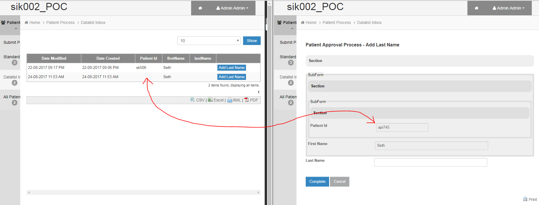

Hello Hugo,
Thank you for your reply. That was extremely helpful. As you suspected, I was using a Datalist Inbox. I have now added a standard Inbox to my Userview and I'm able to see the processes that have been started via the API. How can I create a record row via the API so that the record automatically shows up in the standard Inbox when created via the API? If I update the row from the Standard Inbox it starts to show up in the Datalist Inbox after that, but I need to be able to push the activities along via the API or UI and have them behave the same way.
At the moment, the process that I've built goes thru 2 Activities. On Process start I set a PatientId. Activity 1 is to add the First Name, and Activity 2 is to add the Last Name (I just setup these steps as a simple example to learn how it works). What's strange is that when I start the process via the API and set the PatientId variable, I'm able to see the record in the Inbox, and then complete Activity 1. From the form I can see the PatientId that I set via the API, but when I then look at the record in the Datalist inbox, the PatientId column is empty. In other words, the PatientId displays in the form but not the grid. Any idea what would cause that? (see screen shot)
