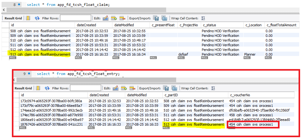

Hi Chris,
Currently, below is my table structure :
Form A= tcsh_float_claim
Form B= tcsh_float_entry.
Form C= tcsh_petty_claim.
At the moment, only voucherNo is created in tcsh_float_entry.
I am expecting Date, GSTAmount,TaxAmount,Amount columns to be created in tcsh_float_entry too.
Do you have any samples for this problem?
Seems like fields in your AJAX subform is not accessible to the form grid.
A possible solution could be: when submitting form B, save it to a separate table. After then, form A can retrieve from that table rather than attempting to reference '2 tables deep'.

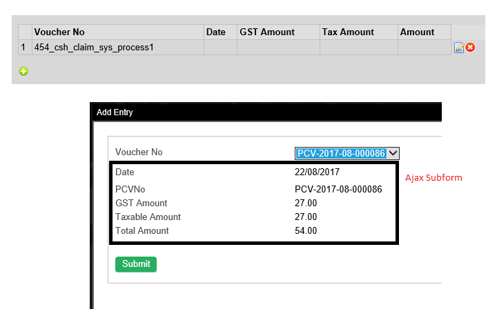

Dear Expert,
I am unable to populate AJAX Subform value into form grid.
Below is my workaround :
1) Form A has Form Grid. Form Grid Columns are voucherNo, Date, GSTAmount,TaxAmount,Amount.
Form Grid is mapped to Form B.
2) Form B has selectbox which is using Default Form Options Binder. I have added AJAX subform and mapped it Form C which has Date, GSTAmount,TaxAmount,Amount. Ajax Subform's Store Binder is Parent Form Binder.
3) Whenever i change voucherNo, (Date, GSTAmount,TaxAmount,Amount) also changes as expected.
4 ) But, the moment I click submit in Form B. voucherNo is populated in form grid with the ID instead of the value. The other columns (Date, GSTAmount,TaxAmount,Amount) remains empty. But, when I view the form B, all the fields are filled up.
Please advise on this. I am also open to any other suggestions.
