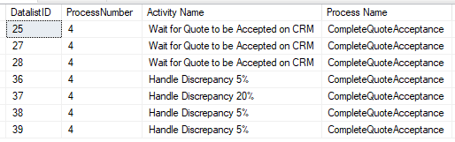

The exact query that I use in the datalist returns 7 rows when run on the database:

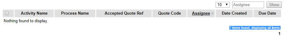

Datalist:
The preview of the datalist shows that it found 7 rows, but not one of them is displayed. What can be the issue?

DatalistID is an auto-increment which I made the Primary Key on the datalist. If my condition in my select is e.g. Datalist > 0 then all records are returned. As soon as I try to filter on another field, only a couple of rows are returned. I tried with int and varchar columns.
The logs contain some errors but do not look related. I am not sure I understand the issue now. "If my condition in my select is e.g. Datalist > 0 then all records are returned. As soon as I try to filter on another field, only a couple of rows are returned." Is that not the expected behavior when filtering?
Hi Anders. Let's say that there are 200 rows in total. What I want to see is 150. If I filter on Datalist > 0, I get 200 rows. If I filter on any other value that's the same on all rows, 150 records are shown as a total on the menu and at the bottom of the list, but only a couple of rows or none are visible. Subsequent pages are empty. Tested the same filters on the database.

In my datalist, linked to a menu item, I query a view which contains an auto-increment integer ID. That ID is the key of the datalist.
The total number of records is correct (200+). Only 6 records are displayed on the screen. Selecting page 2, 3 etc. just return blank pages.
