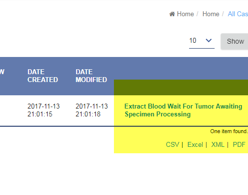

I'm building a process that kicks off multiple async subflows, each of which has steps where the process stops and waits for some event to occur. As a result, the process can have multiple assignments/activities pending at a time. When I view the record in a Datalist, it's hard to distinguish one activity from the other since there isn't a separator. Is there a way to get a separator (i.e. a pipe | ) added between each one?
In this example, there are 3 pending activities. 1) Extract Blood, 2) Wait for Tumor, 3) Awaiting Specimen Processing
