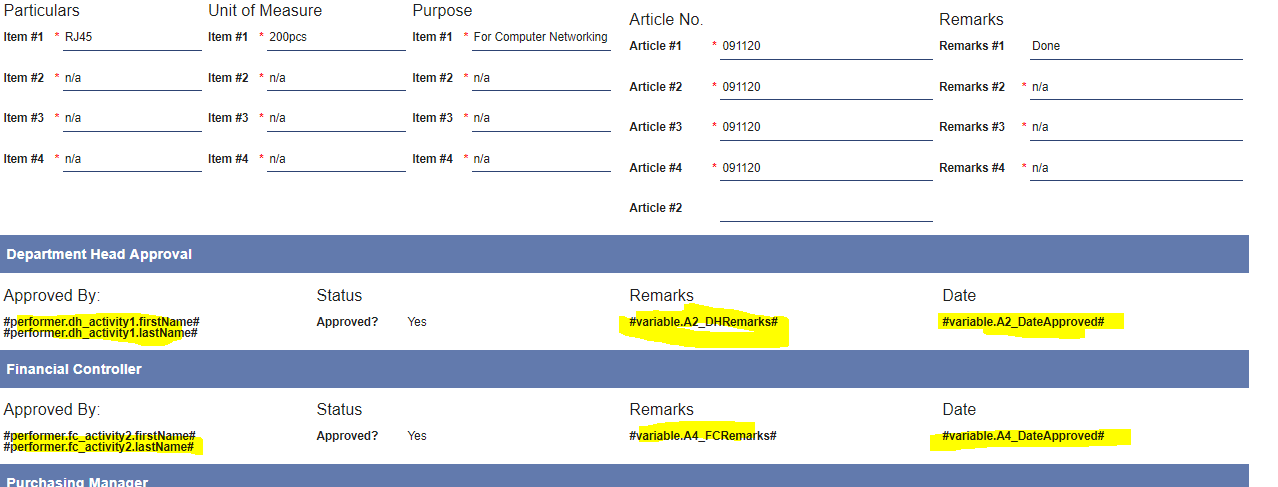

Thanks a lot for your helpful response, I did what you've said, However I'd Just notice that some of the hash variable seems to be not working. Please help...

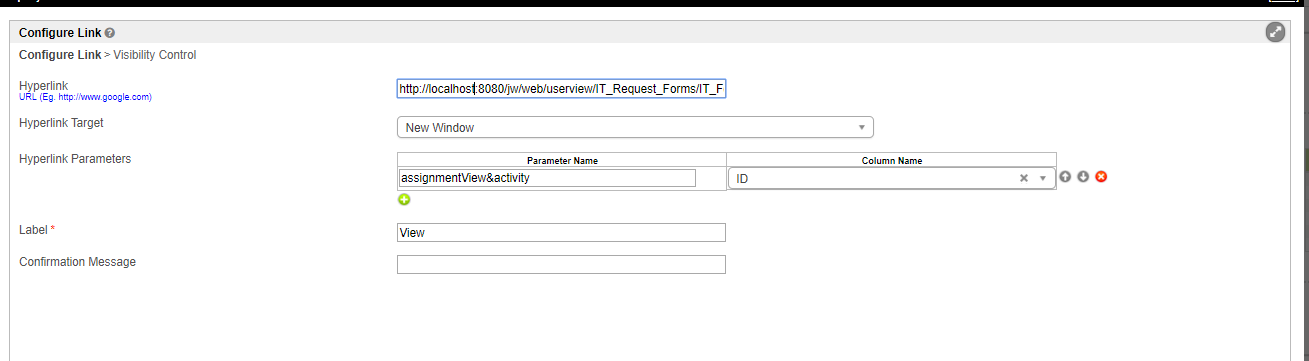

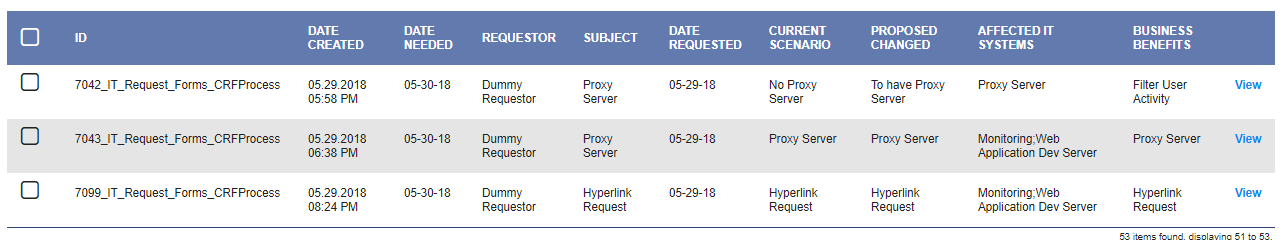

I create a new datalist shown below.
When I click the View, The page directs me to a blank form.
What I want to do is, I want to view what exactly the form looks like when it was submitted/approved in case we need to have a printout of the exact accomplished form.
Below is my current datalist hyperlink configuration.
