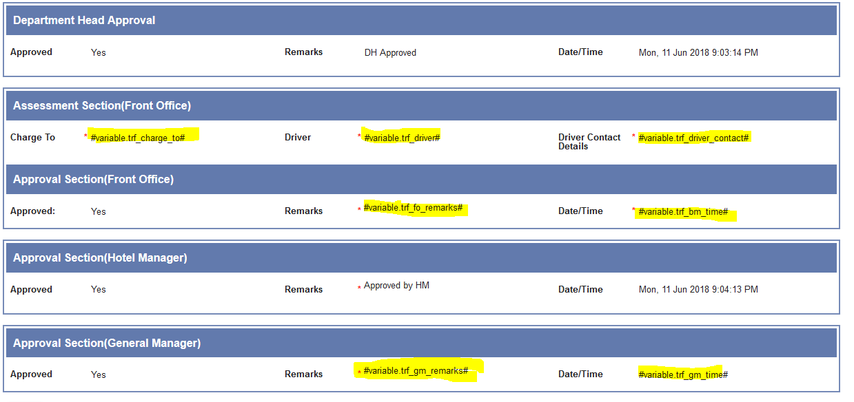

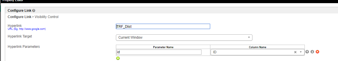

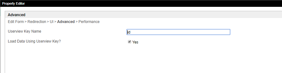

Hi, variable hash variable is workflow assignment related hash variable which only will work when the form is in a process activity. In CRUD, there is no process involved. You should store the value in form instead.

Just having a problem showing the value of a hash variable in a datalist, In some cases, we may need to recall some forms dated back for review.
What I did,
I created a datalist to make a list of the field for the forms.

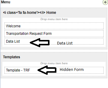

I added List in userview which is also pointing to the datalist that I've created.
I created a hidden form in the user field pointing to form I want to show where userkey name = id
Here's the screenshot.
#1:
#2

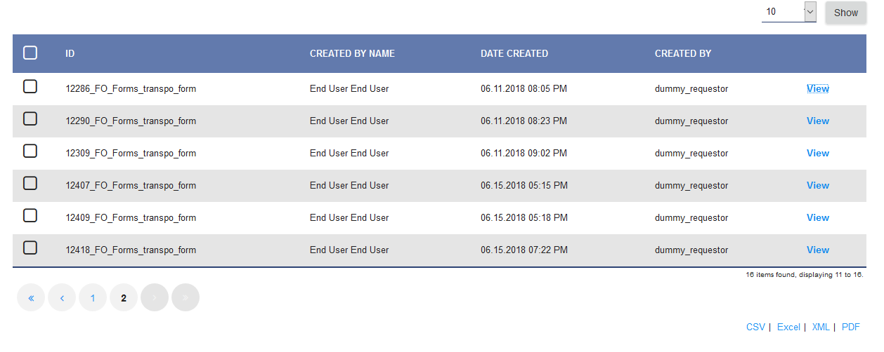

When the user visited Data List, this is what they see.
#3
This is when the user click the View
As you can see, the above highlighted variable is not showing it's value while other's work fine, Not quite sure what I had missed, Please advise.
