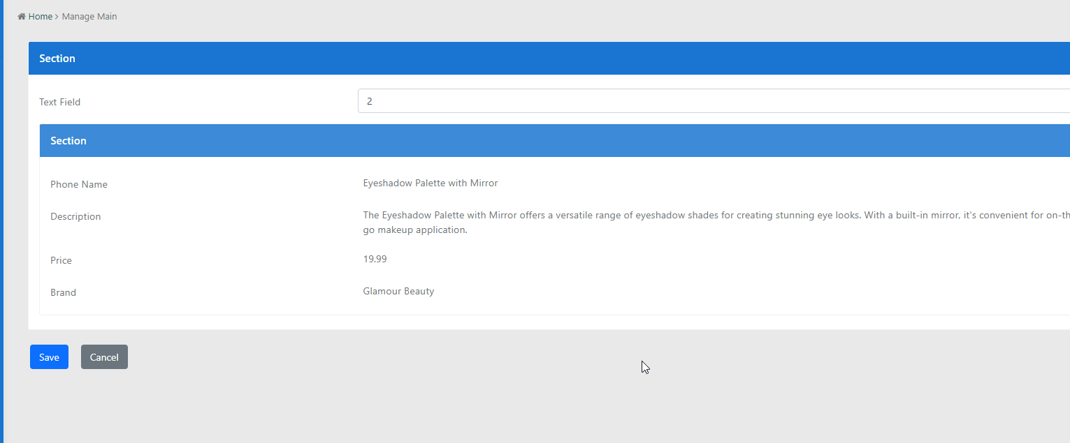

Maybe instead of using a process, you can use a single form.
The form contains a single text field (container no e.g field id = field1) and an Ajax Subform.
The Ajax subform contains the form with JSON API.
configure the Ajax subform > Parent Field to keep Subform ID: field1
ensure to pass the #requestParam.primaryKey# into the JSON API
ref: AJAX Subform - Knowledge Base for DX 8 - Joget | COMMUNITY
then probably use custom html to hide the save button
fyi: i used the JSON Form Data Store - Knowledge Base for DX 8 - Joget | COMMUNITY sample app and modified it as mentioned above and it works
