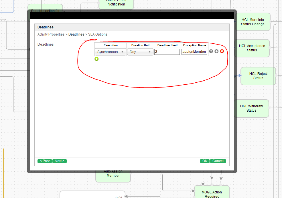

Hi All,
There are 3 activities in a process. If 1st form is submitted from 1st activity then I want to check on 2nd activity, is form submission date and current date have a difference of 2 days then it should trigger automatically to 3rd activity.
Calculation of days should exclude Saturday and Sunday.
Currently it's working fine when including Saturday and Sunday as continues 2 days by using it in activity deadline as shown in image attached below.
I've tried Office Working Hour Deadline, but it's not skipping Saturday and Sunday in deadlines to count days.
I've implemented Office Working Hour Deadline plugin to override the Saturday and Sunday as weekend. But it's not working.
But I need to trigger after calculating 2 days without adding Saturday and Sunday. How I can achieve this?
How I can calculate and trigger it from 2nd to 3rd activity within process ?
