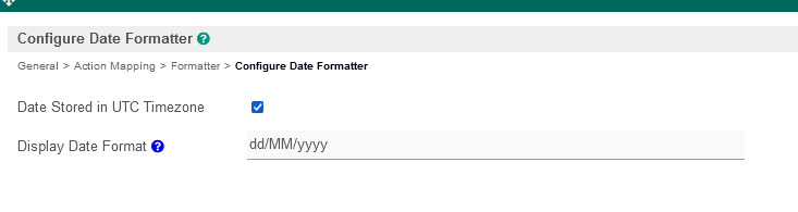

Another error to render in another date time type collumn:
"ERROR 08 Sep 2022 21:21:52 Date Formatter - jwc_paulomnasc : java.text.ParseException: Unparseable date: "2022-09-13" 5303 java.text.ParseException: Unparseable date: "2022-09-13"
Collun configuration in Date formatter: (on Brazil dd/mm/yyyy is a large used date format)
Did you manually write this date? or did you select it from the date picker?
The only way i got this error is by manually writing the date in a different format than the one written in "Data Format" of date picker in form builder
Hy Mohamed.
You´re ok ?
I´m select from the date picker.
