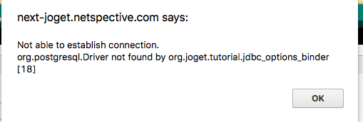

Hello, you need, in fact, the driver. In my case I am using the file postgresql-9.3-1103.jdbc3.jar in the folder apache-tomcat-8.0.20 \ lib and actually my default database is postgresql.
Have you downloaded the PostgreSQL Driver jar ?
No.I am trying to take data from external db which is PostgreSQL .
I am trying to bind data from custom datasource POSTGRESQL.
I am getting this issue when testing connection.Please help.
