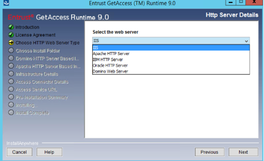

Does Joget can run in a standard Apach environment?
I want to install Entrust GetAccess Runtime in my server to enable the SSO verification.
But seems this software can only configure Apach or IIS or  oracle or Domino.
Unfortunately, Joget only runs in apach-tomat, it’s not a standard apach.
So, does it possible to configure Joget in a standard apach environment?
      Hi, Apache Tomcat is a Java application server, which is different from a web server like Apache HTTP or IIS. You can use a web server as a reverse proxy in front of Tomcat. There are many resources and guides for this online, for example found this https://blog.marcnuri.com/running-apache-tomcat-and-apache-httpd-on-port-80-simultaneously/
